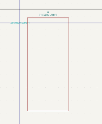

MPamenter
Hi again,
Looks like I spoke too soon.  The downloaded KiCAD symbol is empty.  Looks like this feature is still broken.
Matt
