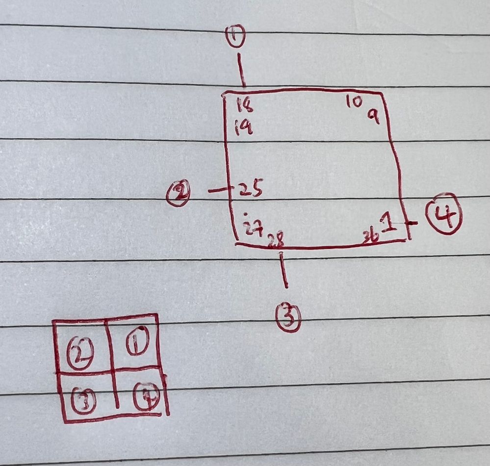

Hey, sorry, I am pretty new to this. I have a rather basic question. I took apart a module that I have, within which there is STM32 microcontroller (part marking: STM32F103T8U77BA7E93PHL739). I want to know if it's possible to use the IDE to extract the existing bin file in the microcontroller, via JTAG or some other method? Reason being I have my own bin file that I'd like to test, but in case I screw things up, I'd like to be able to restore the module back to its original condition by reinstating the original bin file into the microcontroller. So my plan is to extract the current contents of the microcontroller by reading back, store the bin file safely before i do any kind of experimentation so that at least the original condition can be restored. Hope my question is clear.

BTay.1
An update. Turns out I made the rookie mistake of using a faulty probe. After changing the probe, I was able to deduce the following:
0693W00000QKF2fQAH.jpgSocket 1 = Pin 18 of microcontroller
Socket 2 = Pin 25 of microcontroller
Socket 3 = Pin 28 of microcontroller
Socket 4 = Pin 1 of microcontroller
Again the solder traces were tiny so there might be a mistake, but this corresponds to:
VDD_1, VSS_1, PA13, PA14. (ie, power, ground, SWDIO, SWCLK)
Would that make sense?
@BTay.1​  "the solder traces were tiny"
LOL - those traces are huge by modern standards! :face_with_tears_of_joy: :grinning_face_with_sweat:
"(ie, power, ground, SWDIO, SWCLK) Would that make sense?"
Yes, that's exactly what you'd need for an SWD programming/debug connection
(it'd be nice to also have Reset, but not essential).

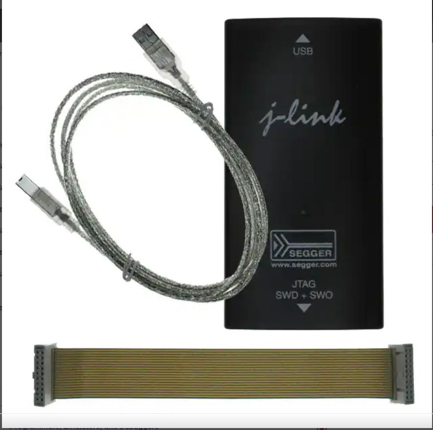

BTay.1
what is the part number of the programmer I have to buy in order to connect my microcontroller to the PC, using this SWD socket?
Regards
Ben
It's a non-standard socket, so you won't find anything "plug-and-go".
But any SWD program/debug probe (which supports your Target voltage) will work - you just need to make an appropriate adaptor.
Since you're on the ST forum, an ST-Link must be the obvious suggestion.
Tools are listed on the Product Page for the microcontroller:
https://www.st.com/en/microcontrollers-microprocessors/stm32f103t8.html#tools-software
In addition every Nucleo-64/144 board has an onboard ST-LINK that can be used as a debugger probe for other boards.
Another popular choice is SEGGER J-Link devices.
BTay.1
Thank you for the suggestion, I am looking at:
this programmer
So I can connect this to the STM32CubeProgrammer, using that?

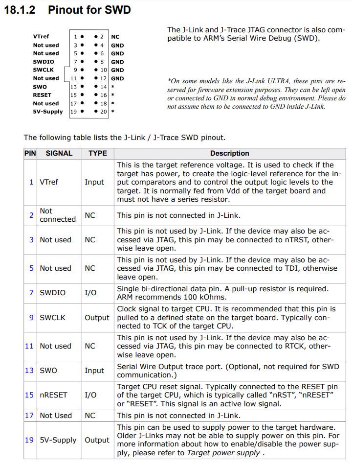

I have to manufacture a cable linking:
Socket 1 = Pin 18 of microcontroller = VSS_1 = GND (pins 4,6,8,10,12 of ribbon cable)
Socket 2 = Pin 25 of microcontroller = SWDIO = Pin 7 of ribbon cable
Socket 3 = Pin 28 of microcontroller = SWDCLK = pin 9 of ribbon cable
Socket 4 = Pin 1 of microcontroller = VDD = pin 1 of ribbon cable
Piranha
Chief II
No. More detailed answer:
https://community.st.com/s/question/0D53W00001SdsrCSAR/cubeprogrammer-with-jlink
In addition to CubeIDE supporting J-Link, you will have these:
https://wiki.segger.com/UM08001_J-Link_/_J-Trace_User_Guide#J-Link_Software_and_Documentation_Pack
As far as I understand, CubeIDE has an integrated J-Link GDB Server. I don't understand why they don't just call the normally installed J-Link GDB Server like some other IDEs do, but hey - we're talking about ST's software...
