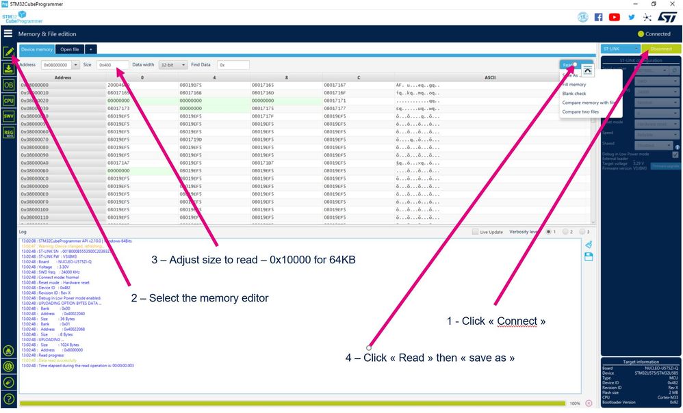

Hey, sorry, I am pretty new to this. I have a rather basic question. I took apart a module that I have, within which there is STM32 microcontroller (part marking: STM32F103T8U77BA7E93PHL739). I want to know if it's possible to use the IDE to extract the existing bin file in the microcontroller, via JTAG or some other method? Reason being I have my own bin file that I'd like to test, but in case I screw things up, I'd like to be able to restore the module back to its original condition by reinstating the original bin file into the microcontroller. So my plan is to extract the current contents of the microcontroller by reading back, store the bin file safely before i do any kind of experimentation so that at least the original condition can be restored. Hope my question is clear.

STM32 Cube Programmer should be able to Read and Save the memory content provided that the device isn't protected to prevent that.​

Hello please use STM32CubeProgrammer:

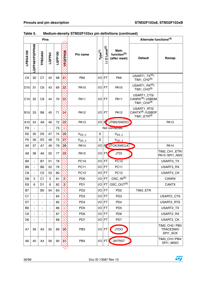

‎2022-06-06 6:36 PM
Thank you for your assistance. I am pretty new to microcontrollers in general. My next question is, I have to connect to this microcontroller. I have no idea what part number it is exactly, as there was no design information or schematics given with this module that I am tasked to investigate. I spot that the microcontroller on the PCB has 36 legs, 9 on each side, which means it is some kind of LQFP36 package, but googling the part number yields no datasheets, the closest datasheet I could find only carries microcontrollers in LQFP48, 64 or 100, so clearly doesnt correspond to the part I have on the board.
There is a small 4-pin header next to the microcontroller, presumably it is the JTAG header, I need to figure out which pins in the header correspond to TMS, TCK, TDI, TDO, by probing with my multimeter. But first I need to know which of the 36 pins on my microcontroller correspond to TMS, TCK, TDI, TDO. This is where I am stuck for now.
I attach the datasheet I found.

The STM32CubeProgrammer should be able to read the device ID and, thus, tell you what chip it is. Unless, of course, your unit is locked. -- In order to this, I need to connect the device to the STM32CubeProgrammer. The only way for me to do this is via a header on the PCB, for which I don't know which pins are TCK,TMS,TDO,TDI and I can only find out via manual probing. And in order to do manual probing I need to first find out which of the 36 pins on the microcontroller on the PCB correspond to TCK, TMS, TDO and TDI.
‎2022-06-07 2:38 AM
While you can program some STM32 (including the 'F103) through full-fledged JTAG, most users use SWD which has two signals - SWDIO and SWCLK.
