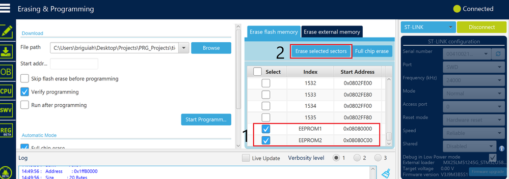

We're using the STM32L071 (or 081), and would like to know how to erase its internal eeprom using the Cube Programmer (we have version 2.10) or any other freely available software, please ?

You can use STM32CubeProgrammer to erase the internal EEPROM, simply connect to your device, then through the "Erasing & programming" menu, select EEPROM banks then click "Erase selected sectors"
Let me know if this solves your issue.
Best regards,
Aziz

Thank-you Aziz - it does solve my issue, and apologies also for not getting back to you much sooner.
And also for not seeing this myself :)
