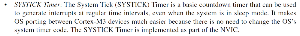

The same as the title, I'm confused that why NOT just use systick as the tick of RTOS.
The aim of the systick is for good portability of the RTOS, yes?
