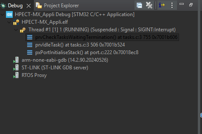

Hi everyone,
I am experiencing issues with Task Aware Debugging (FreeRTOS Task List) in the latest version of STM32CubeIDE. The "FreeRTOS Task List" view is either empty or not populating correctly, despite the scheduler running and tasks executing effectively on the hardware.
Environment:
  • IDE: STM32CubeIDE (Latest Version)
  • MCU: STM32H7S3L8H6x
  • FreeRTOS Version: V10.6.2 (CMSIS-RTOS V2 wrapper)
  • STM32Cube 2.0.0
Interestingly enough, the runtimestats itsef are working.
Does anyone have similar issues?

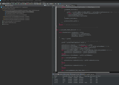

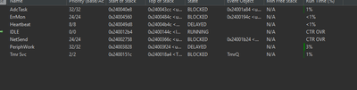

Hello @Vidar @rnoh
I launched the Debug Session using FreeRTOS_Mutex example on Nucleo-H7S3L8.
I get the same results on STM32CubeIDE 1.16 and STM32CubeIDE 2.0.
STM32CubeIDE 1.16
STM32CubeIDE 2.0
Thanks.
Mahmoud

I encountered a similar issue with STM32CubeIDE (versions 1.19.0 and 2.0.0) while debugging FreeRTOS on Nucléo board (with the V2J46M33 Stlink firmware).
My project had worked last year with 1.16.0. STM32CubeIDE
As a workaround, I used a Jlink SWD probe instead.
Kind regards

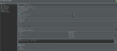

That is the IOC File!
Hello @Vidar
Thank you for interaction.
When I compile the project with the shared Ioc.File , I get compilation errors.
Thanks
Mahmoud

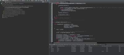

Hi all,
I noticed the same behavior as @Vidar had, but after updating to the latest version 2.1.1 on Ubuntu (I don't remember what the exact version was before, but definitely 2.0.0 or higher). Previously everythink worked fine.
After "Suspend", in the Debug View on the left I saw only one thread instead of several. In the console there was also a message "Update threads. Failed collecting threads.". Similar behavior has been observed also here:
https://community.st.com/t5/stm32cubeide-mcus/freertos-rtos-kernel-awareness-not-working-on-cubeide-1-8-0/td-p/97251
https://community.st.com/t5/stm32cubeide-mcus/unable-to-use-debugger-while-monitoring-multiple-threads/td-p/764811
I did a downgrade (full reinstall) to 2.0.0 using Generic Linux sh script, and now it works as previously.
Platform: Ubuntu 24.04.4 LTS
FreeRTOS version: V10.5.1
MCU: STM32U585 (on custom board)
