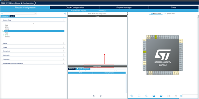

I am working on the FREERTOS based project and i need to disable the code generation for pendsv handler, systick handler, svc handler .
As this handlers are written in freeRTOS, I am getting error for multiple definations.
I have seen the option to skip the code generation in previous versions of the software but now i am not able to do so.
you can see an empty page in code generation option. Please help solve the issue.

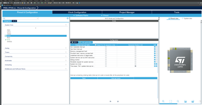

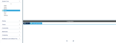

Hello @AADESH ,
I loaded the Ioc.File and the behavior described is reproducible using the MX integrated in STM32CubeIDE.
I suggest that you move up the configuration window.

Hello @Mahmoud Ben Romdhane ,
Thank you very much for the quick solution. .
I have tried installing the previous version thinking this can be the bug in latest software but find the same in earlier versions as well.
Never thought this can be the solution.
