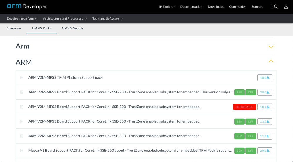

You can find the package at this url https://developer.arm.com/tools-and-software/embedded/cmsis/cmsis-packs

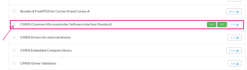

The package 5.8.0 works for me but not the 5.9.0

Sorry I couldn't copy the direct link, anyways the CMSIS pack is placed under: ARM -> CMSIS (Common Microcontroller Software Interface Standard).

You should install ARM.CMSIS.5.8.0.pack, I also couldn't install v5.9.0.
@eLuigi​ screenshots shows where to find the pack. You need to click on the "+" that is next to "CMSIS (Common Microcontroller Software Interface Standard)" to list the available and different versions of the CMSIS pack.
You can find the "CMSIS (Common Microcontroller Software Interface Standard)" above "CMSIS Embedded Compute Library".
