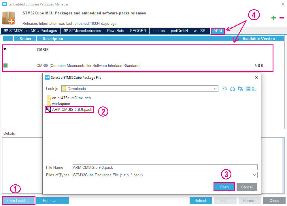

Hello @MM..1​ , @Robmar​ , @eLuigi​ ,
Thanks for your feedback,
The CMSIS pack can be downloaded from arm website and then imported locally in CubeMX, please refer to the picture below,
I hope this helps !

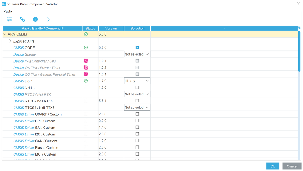

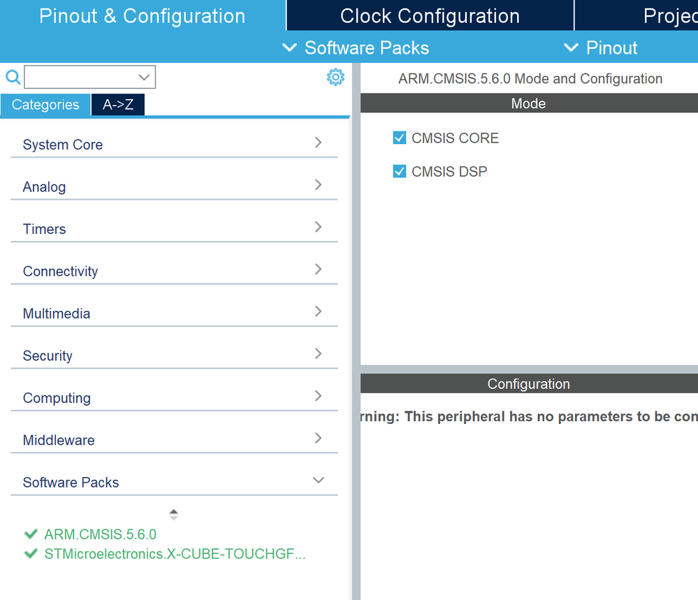

Ok in 1.7.0 i can make two clicks and all is setup in IDE.
Version placed in project is arm_math.h
* @version V1.6.0
* @date 18. March 2019
but, in fw folder STM32Cube_FW_F4_V1.26.2 same file
* @version V1.5.3
* @date 10. January 2018
as you can see MX dont place DSP from fw , but newer.
??? ofcourse too lib files is very different = very unclean

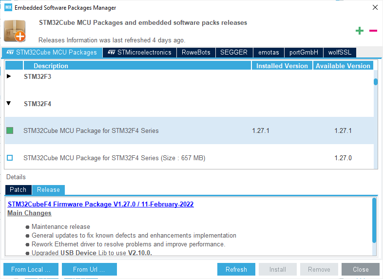

‎2022-11-09 7:25 AM
Not sure what you mean, I'm using 1,10, latest version
‎2022-11-09 10:37 AM
Hello @MM..1​,
I'm curious how you add it in the IDE in two (maybe more) clicks ?
Because on my side I have followed instructions of the link in my previous message and it's quite a pain to do.
I'm on CubeIDE 1.10 as Robmar
PS: the most recent version of your arm_math.h is the same as in the F4 1.27.1 fw version, so maybe you have already download it too.
thank you,

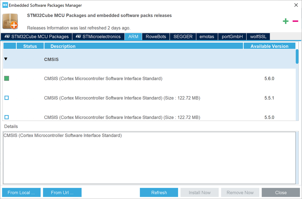

‎2022-11-09 10:59 PM
I ever use my stable IDE and compare with latest, now 1.7 vs 1.10
In 1.7
and PS 1.27.1 have file
* @version V1.5.3
same as 1.26.1 , but older as from ioc MX in 1.7

‎2022-12-08 4:36 AM
I hope this helps !
If your issue is solved, please close this post by clicking the "Select as Best" button. This will help other members of the community find this response more quickly :)
Sara.
