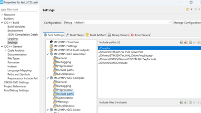

Include paths are in project properties:

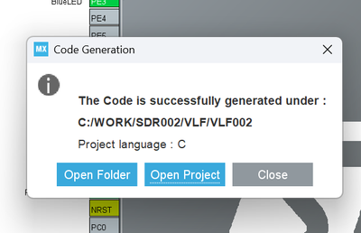

this is the result of "generate code" in MX
... and when I press open project.

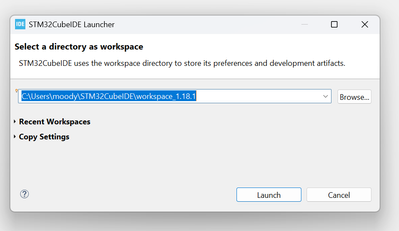

cubeIDE opens my default workspace below ..

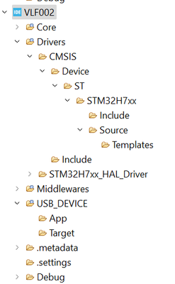

BUT.... the project file heirarchy is there but contains no generated source files ...
the files are actually  in the MX directory above.

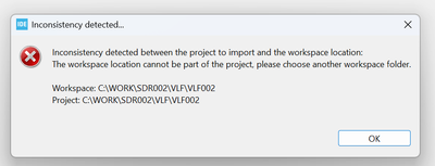

when I try to set the IDE workspace to where MX actually put the files ... I get the workspace conflict error message.
