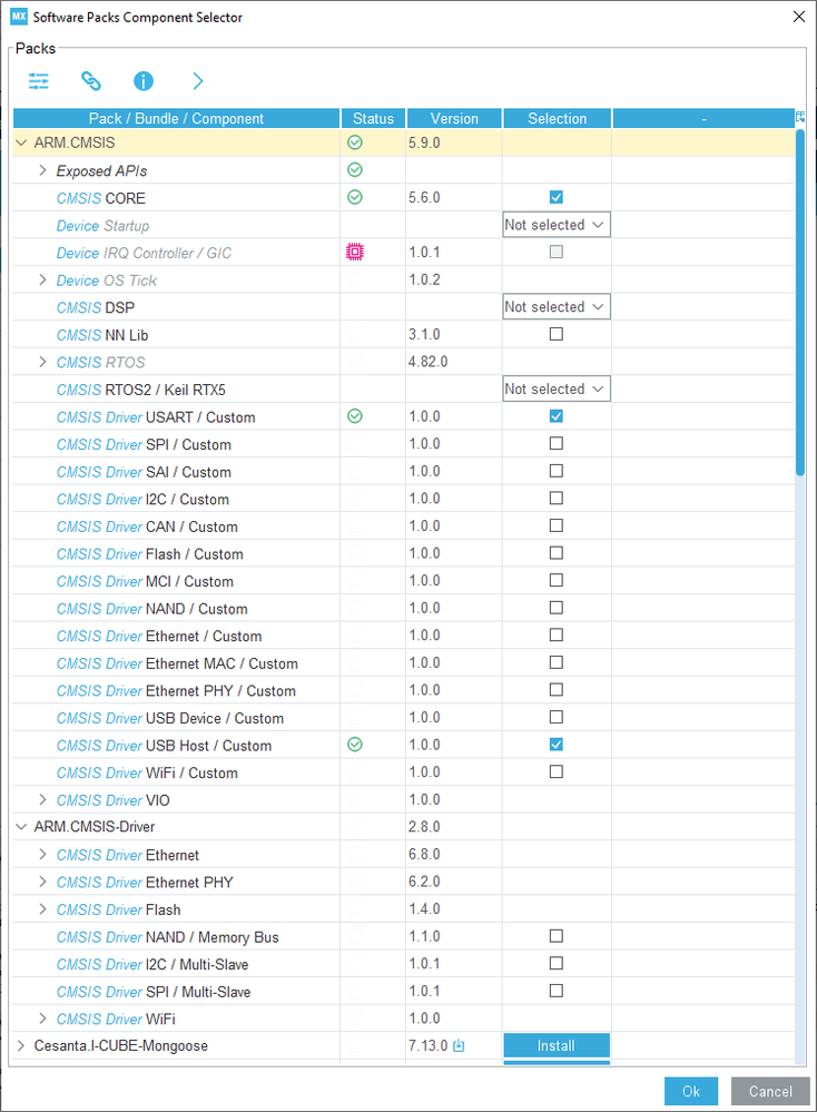

What a pain, so finally got around to trying to test our code with the CMSIS DSP, went into the component selector, selected CMSIS modules, DSP, and clicked OK, as there was no big flashing INSTALL button, and nothing happened!
It didn't install the DSP folder after code generation, sure this is easy right, but obvious it is not.
Any pointers?
‎2023-02-01 2:48 PM
Man you seem to have an issue with comprehensive reading. You probably ignored the warning given by the component selector, and did not enable CMSIS CORE. CMSIS DSP stands on top of CMSIS CORE.
You're probably going to continue having issues that you're not going to know how to resolve by yourself. I suggest you to ignore the component selector and just copy and paste the source code:
https://github.com/ARM-software/CMSIS_5/releases/tag/5.8.0
Try reading a guide on how to add a library to your code:
https://community.st.com/s/article/configuring-dsp-libraries-on-stm32cubeide

I'm also having problems installing this CMSIS stuff. In my case I want to use it with USB-Host.
I have downloaded and installed:
- ARM.CMSIS.5.9.0.pack
- Keil.STM32F4xx_DFP.2.17.1.pack
Here is what I have configured in stm32cubeide:
Is this enough? (Why is there no USB under ARM.CMSIS-Driver?)
So now I want to take a first step with USB.
On this page I found some example code.
So, I added the first two lines of the example code into my source code:
extern ARM_DRIVER_USBH Driver_USBH0;
ARM_DRIVER_USBH *drv_info;
And this fails...
So, what do I need more? An include file, perhaps? But which one? I'm clueless where to find it.
Or perhaps more driver sources? If so, where could I find it?
I would like to see an example of how to use CMSIS in STM32CubeIde for use with USB Host, but Google and Youtube have not been helpful so far.

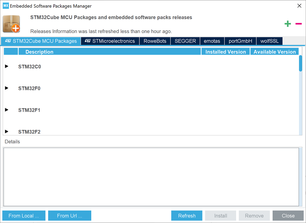

‎2025-01-08 10:18 AM
Why in hell do I need to download the packs at the ARM website? Is it a legal issue? When using Keil MDK, I can just search through all packages which seem to be linked to Arm Keil | CMSIS Packs. Isn't the idea of a pack installer that I don't need to check-in all the gigantic libraries into source control?
Just started with Cube, but this is *highly* confusing.
