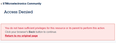

2025-08-29 9:02 AM
@waclawek.jan wrote:...
Note, that ST pushes Cube, mostly in its HAL form, and refuses to work on register based examples.
That link is broken.
