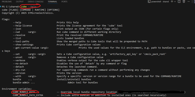

This is not a completetly tested tutorial, but could be a starting point:

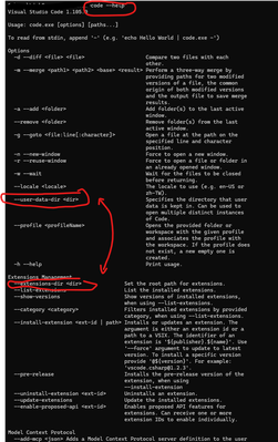

For VS Code itself, use the system-wide installation option.
For VS Code extensions, you may use code --extensions-dir <common folder> to use centrally managed extensions.
For STM32Cube bundles and other stuff, there is a cube executable which you can call from a VS code terminal.
cube --help will show environment variables which you can tweak to point to centrally managed folders.
hth
KnarfB
