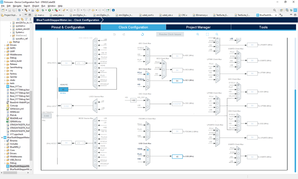

For the USB CDC, it is important to configure the USB clock to the correct frequency, typically 48 MHz This clock is derived from the system clock, so it is also important to ensure that the system clock is configured to the correct frequency as well.

As you can see the internal 48MHz clock is by default linked to the USB. So that's not the issue I think. I have even tried setting Pclk to be 48MHz still did not work.

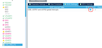

The USB interrupt was not enabled
Missing
HAL_NVIC_SetPriority(USB_UCPD1_2_IRQn , 6, 0);
HAL_NVIC_EnableIRQ(USB_UCPD1_2_IRQn);

Let's do those steps :
1-Create project in CubeMX
2-USB-->Device FS
3-RCC-->Select HSE clock-->(Bypass clock source )
4- Select CDC class in MiddleWares
5-Go to clock configuration --> Set 8 MHz as input frequency
6-Make sure that the frequency for USB CDC is 48Mhz
Please try this solution and I will be waiting for your feedback don't hesitate to raise any question
Thx
Ghofrane
Visitor II
November 17, 2025
for me, I got USB device not recognized when init project too and I just enable interrupt in NVIC than it work
