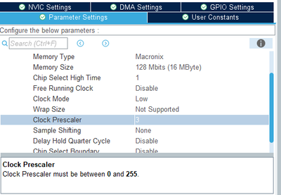

Hello everyone,
I have a question regarding the configuration of the OCTOSPI, especially the prescaler value.
I am using the UI to configure the XSPI's prescaler and setting it to 3.
The generated code is as follows. You can see that the prescaler value is set to 3.

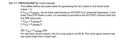

In the function "HAL_XSPI_Init" you have this part:
/* Configure clock prescaler */
        MODIFY_REG(hxspi->Instance->DCR2, XSPI_DCR2_PRESCALER,
                   ((hxspi->Init.ClockPrescaler) << XSPI_DCR2_PRESCALER_Pos));
The register is directly set with the value of "ClockPrescaler".
However, in the user manual it's written:
Meaning, that if the value "ClockPrescaler" is "3" the prescaler is actually 4.
Shouldn't the register be set with the value "ClockPrescaler - 1" instead of "ClockPrescaler" ?

It says the valid range is 0 to 255. Subtracting one from it doesn't make sense here.
The Pulse value and Reload values for timers have the same drawback. The description could be updated to be more clear.
It's going to be confusing one way or another since the field itself is named PRESCALER with the description "Clock Prescaler" in the Reference Manual yet the clock scaling factor is (PRESCALER + 1). Just something you need to learn and adapt.

Updating the description would make this clearer.
I guess it's something to keep in mind when using the OCTOSPI.
