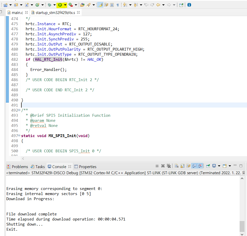

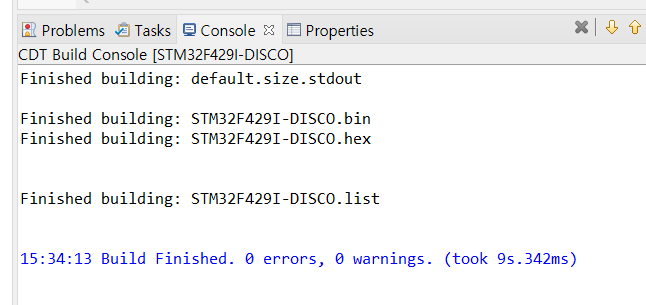

Hi, I want to use the RTC. ( Use STM32F429ZI Discovery board )

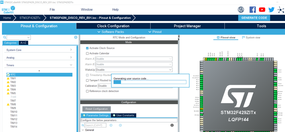

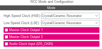

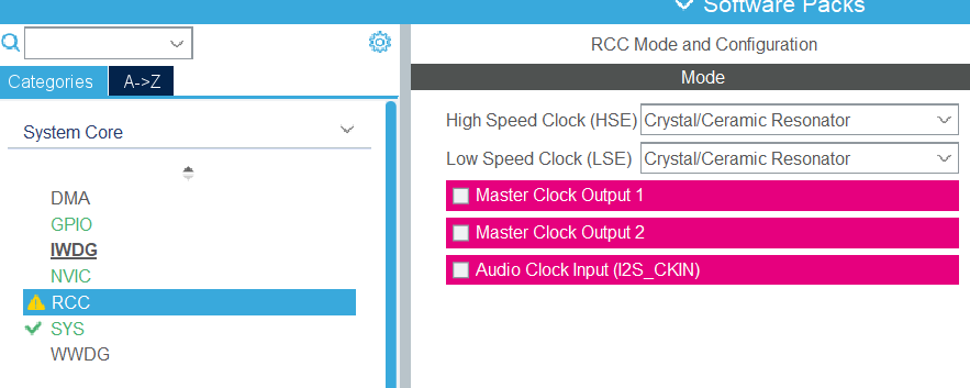

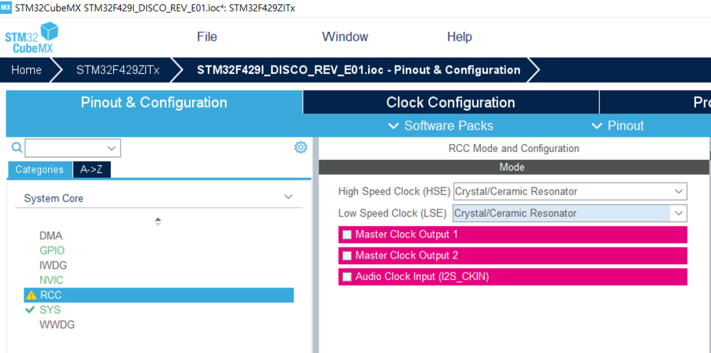

So, I set
1. RCC-> High Speed Clock Cystal/Ceramic Resonator
RCC-> Low Speed Clock Cystal/Ceramic Resonator

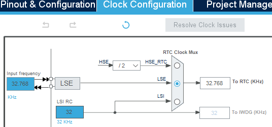

2. Clock Configuration -> RTC Clock Mux -> LSE

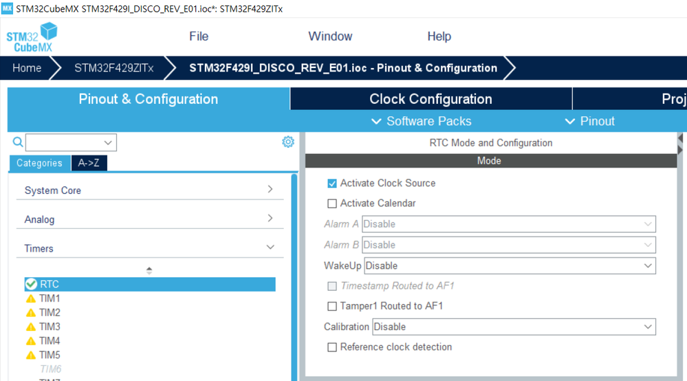

3. Pinout & Configuration -> Timers -> RTC -> Active Clock Source

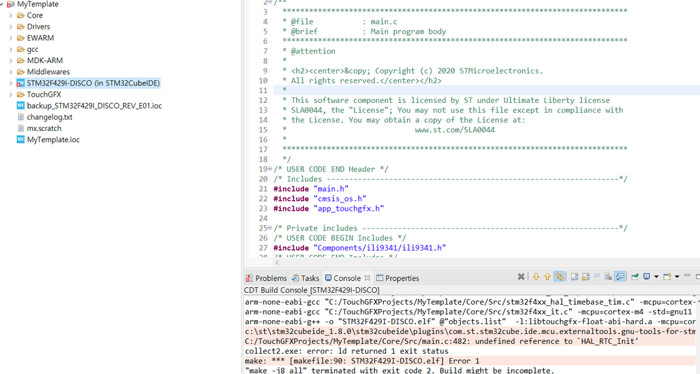

4. Generate Code and Build project but, failed
Can you help me to solve this problem?

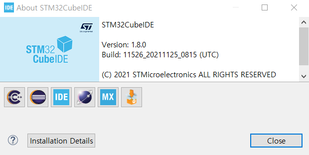

First on my side, I started a new project following the same steps as you and it works properly. You can try it on your side with my project attached. I am using STM32CubeIDE V1.7.0.

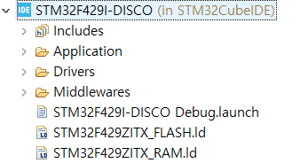

2022-01-20 5:43 PM

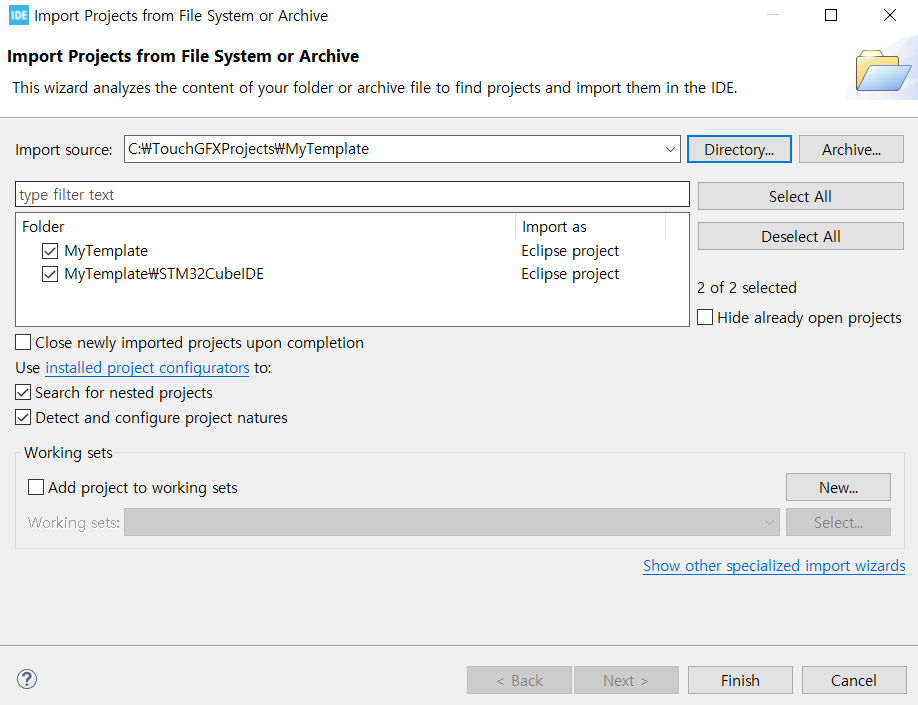

I think, the problem is importing from TouchGFX to STM32CubeIDE.
TouchGFX Desinger version is 4.18.1
The order of execution is as follows.
I ran a few test( DAC, ADC, UART ..), but all failed with similar problem.
( Undefined reference to 'HAL_DAC_init' ...)
Can you help me, how to import from TouchGFX to STM32CubeIDE?
2022-01-21 1:24 AM
Hi @지용 한 ,
Thank you for your detailed description.

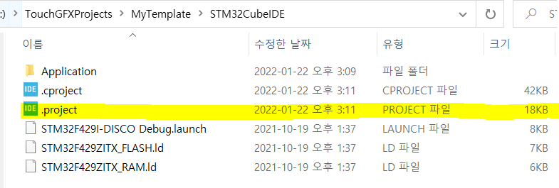

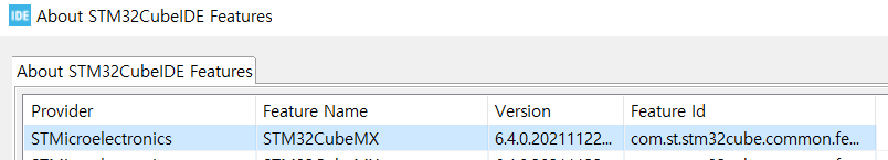

By following your steps I had the same issue, but I find a workaround that can help you :) . Before that please have you followed those installation steps.
Please can you try that on your side :
That should solve your issue for now.

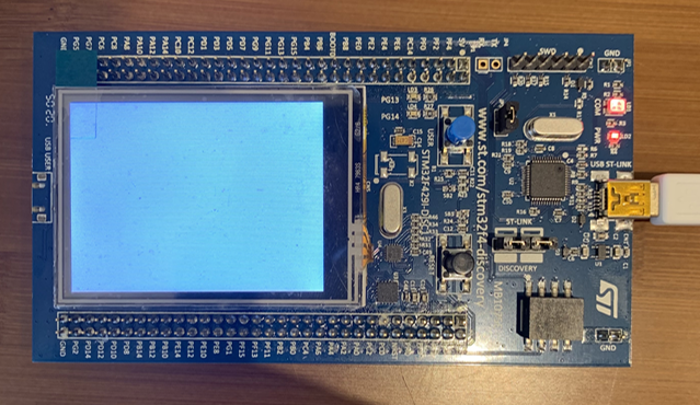

2022-01-21 10:50 PM
Thank you for your help.
But, I have another issue.

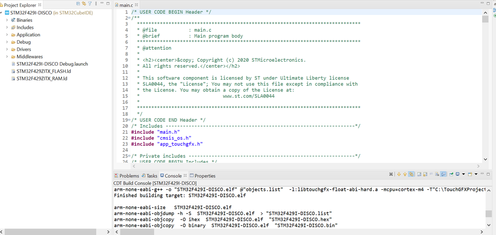

I finished downloading the firmware, but nothing displayed on the LCD.
My Steps:
In STM32F429ZI-Discovery board, the LD1 LED blinks during firmware download.

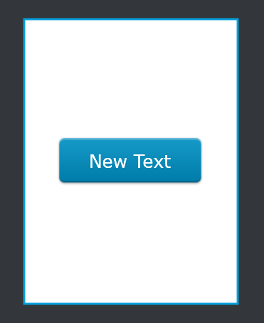

Go to C:\TouchGFXProjects\MyTemplate\ open the file MyTemplate.touchgfx, I can see icons.
In TouchGFX, I can run simulator and see icons.
Could you help me the problem what is?

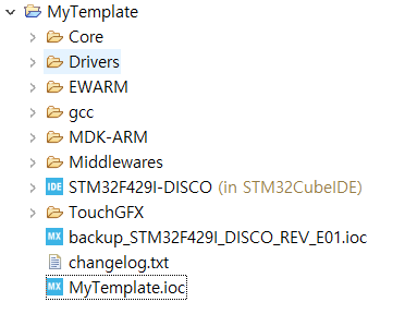

2024-10-25 5:57 AM
I understand what's problem.
If you take look at the hierarchy under driver/stm32f4xx_HAL_Driver.
You will notice hal file related to rtc not present. You have to link this file path so that this file will be available.
And after that compile code.
