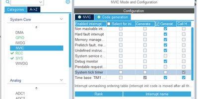

2024-10-22 11:45 PM
Dear j0of
According to your way, I have fixed my error in my project. I trying to add freertos into my board which is stm32f103zet6. Maybe you should not generate Systick_Handler in NVIC setting. I hope it will help you.
Best wishes!
