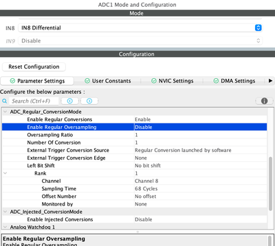

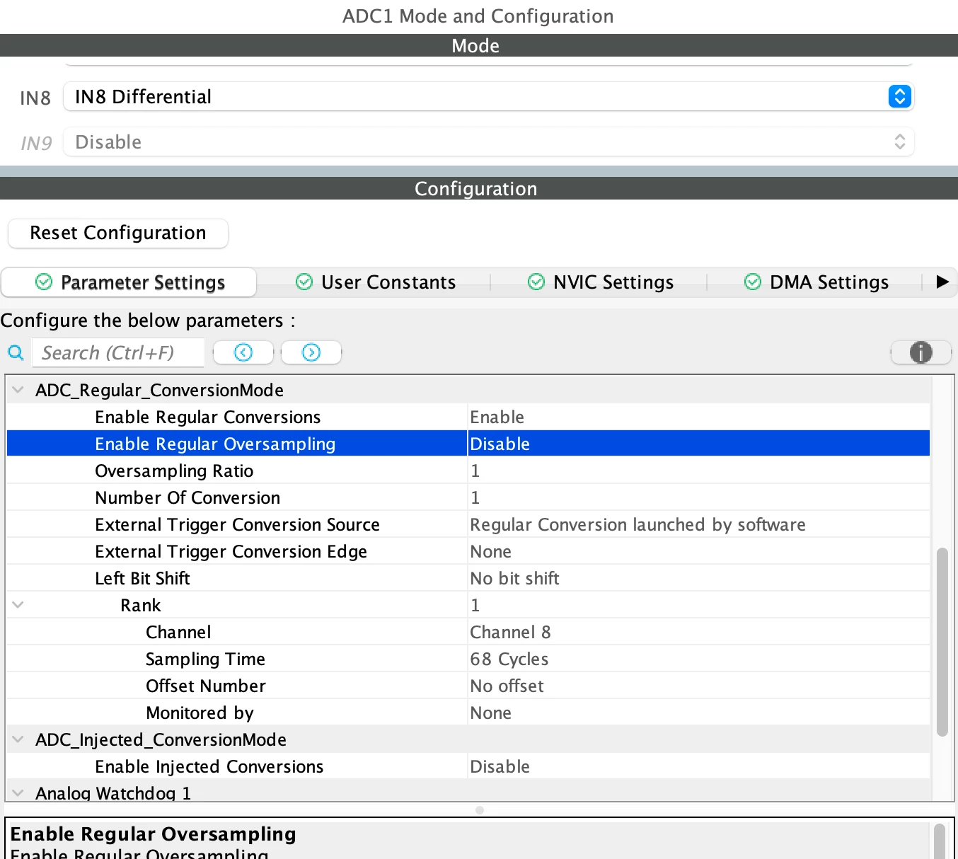

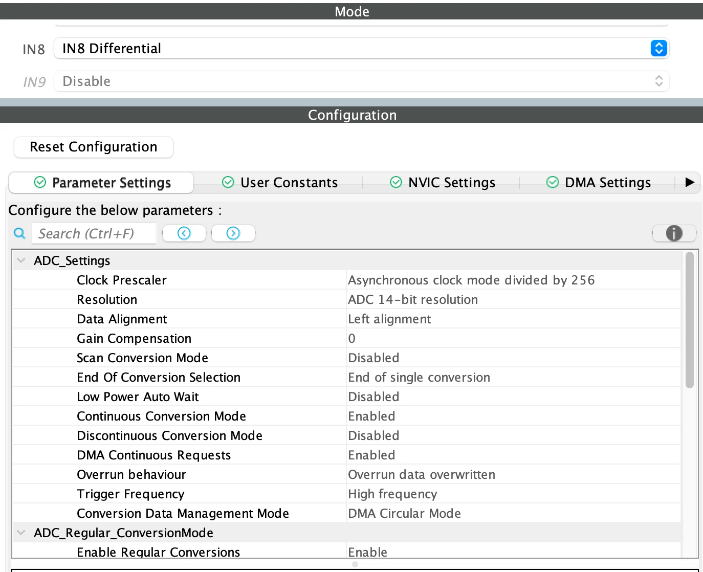

I got some problem with using ADC Differential Mode.
When I am using ADC Single Ended Mode:
Channel 8 Reading: ~8735
Channel 9 Reading: ~10907
When I am using ADC Differential Mode:
Reading: ~7106
That's weird. ADC Differential Mode should be subtracting both reading so suppose I should get 8735-10907=-2172? Why I will get 7106? Is it the signing problem? I already use int16_t instead of uint16_t
Does anyone can help me on this?
Thank you!!!!
Best answer by waclawek.jan
Differential conversion results are mid-centered and half-gain to fit the full range.
8192 + (-2172 / 2) = 7106.
See relevant sections of ADC chapter in RM.
P.S. Read also relevant sections of datasheet, note the rather limited common-mode range.
6 replies
waclawek.jan
waclawek.janBest answer
October 21, 2024
James613Author
October 21, 2024
Oh I see! Thank you so much!!!!
James613Author
October 21, 2024
But is there anyway to directly output signed value from ADC?
MasterT
Lead II
October 21, 2024
Try data alignment "right adjust"
waclawek.jan
October 22, 2024
See Offset section of Data management subchapter of ADC chapter in RM, and description of ADC_OFRy register.
James613Author
October 22, 2024
Thank you so much! I did it!
ADC1->OFR1 = 0; // Clear the offset register first
ADC1->OFR1 |= (8192 << ADC_OFR1_OFFSET1_Pos); // Set the OFFSET to 8192
ADC1->OFR1 |= (1 << ADC_OFR1_SSAT_Pos); // Enable signed saturation
ADC1->OFR1 &= ~(1 << 24); // Set POSOFF to 0 (negative offset)
ADC1->OFR1 |= (8 << ADC_OFR1_OFFSET1_CH_Pos); // Apply the offset to ADC Channel 1
And also set left shift bit by 1 to mutiply the result by 2.
