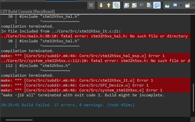

I am currently trying to develop for the STM32H573RIT6 microcontroller, however after generating a new project I run into an issue where I am unable to compile any code due to main.h attempting to include "stm32h5xx_hal.h", but it fails to compile as it fails to locate that file. The only file that I was able to locate was "stm32h5xx_hal_conf.h", but replacing that in the "main.h" file still fails to compile as it cannot find "stm32h5xx_hal_spi.h" and "stm32h5xx_hal_gpio.h". system_stm32h5xx.c also attempts to include the "stm325xx_hal.h" file as well and as a result errors.

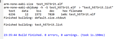

I tried to reproduce your behavior, and I was not able to generate the code. Knowing that I am using STM32CubeMX 6.14.1.
After investigation, I found a mismatch and contradiction between the MCU reference (Mcu.Name=STM32H573RITx) and the Firmware Package (STM32Cube FW_H7 V1.12.1) by opening the Ioc.File with Note Pad.
I imported the same configurations through a new Ioc and the project build was finished with 0 errors.
