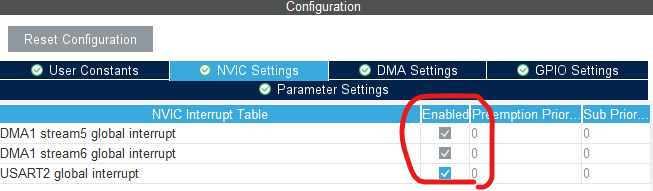

Hi Team
UART DMA not works with STM32F767ZI and STM32F745VE.
It does not transmit or receive data.
Testing same code with STM32F405 and STM32G474, UART DMA works fine.
Does anyone know why UART DMA doesn't work on STM32F?
Is there anything to be care of RAM setting when use UART DMA?
My dev. environment:
  • STM32CubeIDE Ver1.8.0
  • FW Package Ver: FW_F7 V1.16.2
Below is my test code.
※This code will not work unless the DMA and UART interrupts are enabled.

Hi everyone.
I found the cause of this problem.
There was STM32CubeIDE (CubeMX) generated code bug!
If UART is initialized before DMA, UART DMA will not work.
The UART should be initialized after DMA.
For example, this initialization sequence, UART DMA doesn't work.
MX_UART4_Init();
MX_UART5_Init();
MX_DMA_Init();
And, this initialization sequence, UART DMA work.
MX_DMA_Init();
MX_UART4_Init();
MX_UART5_Init();
As far as I tested, behavior is same on STM32F4 / G4 / F7.
This is a bug of STM32CubeMX code generation.
I hope this will fix by STMicroelectronics.

Hi MM..1 -san
Above code works with STM32G4 and STM32F4 MCU.
And UART transmit and receive function with DMA doesn't work with STM32F7 MCU.
In short, these functions not works, the others works.
  • HAL_UART_Transmit_DMA()
  • HAL_UART_Receive_DMA()
I want to use UART with DMA for transmit and receive data.
DDurk.1
I had a similar issue, for me it was the interrupt priority settings on the NVIC tab under Pinout and Configuration in CubeMX. Lower numbers are higher priority. I would also check the clocks for the USARTS to make sure they are adequate, check the baud rates etc are the same and the GPIO speeds on the USARTS are adequate.

Hi @Kenji​ ,
Glad to know that you found the solution to your issue.
But I would like to inform you that this is a known issue and fixed with STM32CubeMX 6.4.0.
But you may have a side effect in case you want to regenerate an old project with latest version of the tool.
Some more details on how to fix it in MX_DMA_Init order in the main.c file generated by STM32CubeMX, How to fix?

Hi @Amel NASRI​
I use this version of,
  • STM32CubeIDE: Version: 1.8.0 , Build: 11526_20211125_0815 (UTC)
  • STM32CubeMX: Version: 6.4.0-RC4, Build: 20211122-2105 (UTC)
It may be a known problem, but it hasn't been solved in CubMX6.4.0.
If it's a known problem and if you say that it have fixed,
please fix it well, and check before release CubeIDE or CubeMX software.
Also, it should give a warning, in case wrong initialization function calls.
About main.c, I fix [project manager]->[advanced settings]->[generated function calles] for code generation.
Hi @Kenji​ ,
Issue is fixed for projects created from scratch with CubeMX 6.4.0.
As explained in the question I shared previously, correct workaround is provided for projects cerated in a previous version with that issue. This is what you have already applied.

Thanks for your feedback,
Unfortunately this issue was partially fixed in v6.4.0. When creating a project from scratch (with DMA enabled), the order is generated correctly.
However, if we start project with no DMA, generate and then enable it, the order become wrong.
The Workaround is to always check the order in [project manager]->[advanced settings]->[generated function calls] before generating the code.
This issue will be properly fixed in the upcoming releases.
Sorry for the inconvenience it may cause.
About the warning proposition, I'll check internally with the team and see how we can address a modification. I will keep you posted with the updates.
Thanks @Amel NASRI​  for flagging this to us.
Sara.
