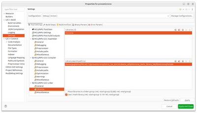

Hi everyone,
I'll start by saying I'm just starting to use STM32cubeIDE. I'm having trouble configuring the microros configuration  in my project involving an STM32F767zi board.
Specifically, I managed to include everything I needed, and now when I compile, the result is as follows:
make -j8 all
docker pull microros/micro_ros_static_library_builder:jazzy && docker run --rm -v /home/guglielmo/PROJECTS/provamicroros:/project --env MICROROS_LIBRARY_FOLDER=micro_ros_stm32cubemx_utils/microros_static_library_ide microros/micro_ros_static_library_builder:jazzy
jazzy: Pulling from microros/micro_ros_static_library_builder
Digest: sha256:1482f3df56184ecc5d4a9d45ad9be0a17a84a91fca947d07f20d1678b23f6243
Status: Image is up to date for microros/micro_ros_static_library_builder:jazzy
docker.io/microros/micro_ros_static_library_builder:jazzy
dos2unix: converting file /project/micro_ros_stm32cubemx_utils/microros_static_library_ide/library_generation/library_generation.sh to Unix format...
micro-ROS library found. Skipping...
Delete micro_ros_stm32cubemx_utils/microros_static_library_ide/libmicroros/ for rebuild.
arm-none-eabi-gcc -o "provamicroros.elf" @"objects.list" -lmicroros -mcpu=cortex-m7 -T"/home/guglielmo/PROJECTS/provamicroros/STM32F767ZITX_FLASH.ld" --specs=nosys.specs -Wl,-Map="provamicroros.map" -Wl,--gc-sections -static -L/home/guglielmo/PROJECTS/provamicroros/micro_ros_stm32cubemx_utils/microros_static_library_ide/libmicroros/include --specs=nano.specs -mfpu=fpv5-d16 -mfloat-abi=hard -mthumb -Wl,--start-group -lc -lm -Wl,--end-group
/home/guglielmo/st/stm32cubeide_1.19.0/plugins/com.st.stm32cube.ide.mcu.externaltools.gnu-tools-for-stm32.12.3.rel1.linux64_1.1.0.202410170702/tools/bin/../lib/gcc/arm-none-eabi/12.3.1/../../../../arm-none-eabi/bin/ld: cannot find -lmicroros: No such file or directory
collect2: error: ld returned 1 exit status
make[1]: *** [makefile:66: provamicroros.elf] Error 1
make: *** [makefile:59: all] Error 2
"make -j8 all" terminated with exit code 2. Build might be incomplete.
Can you help me or tell me if there's already a post like this I can consult?
USER_RG
I fixed the library link search path as
/home/guglielmo/PROJECTS/provamicroros/micro_ros_stm32cubemx_utils/microros_static_library/libmicroros
and now build properly......
THANKS

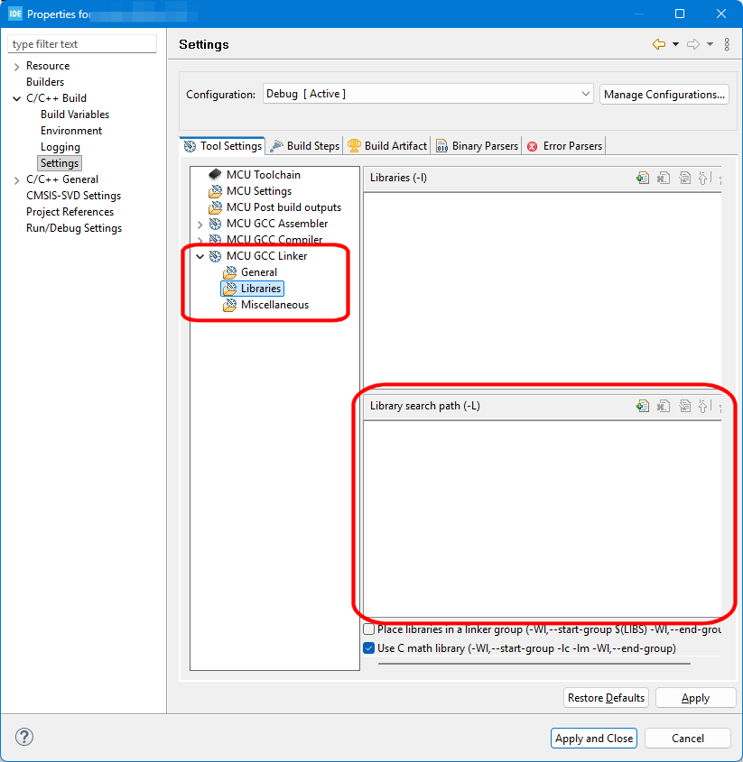

So that's the linker saying it can't find microros - presumably that's a pre-built library?
Does that library actually exist in your project?
If it does, is it in a place where the Linker is searching?
You specify the Linker search path here:

My linker search path is made as in the follow figure
libraries: microros
libraries search path: /home/guglielmo/PROJECTS/provamicroros/micro_ros_stm32cubemx_utils/microros_static_library/libmicroros
note: My workspare is:
But the error indicates that it does not include something at the following link:
the path of libmicroros.a is
but not incluede  microrso....
USER_RG
THANKS
