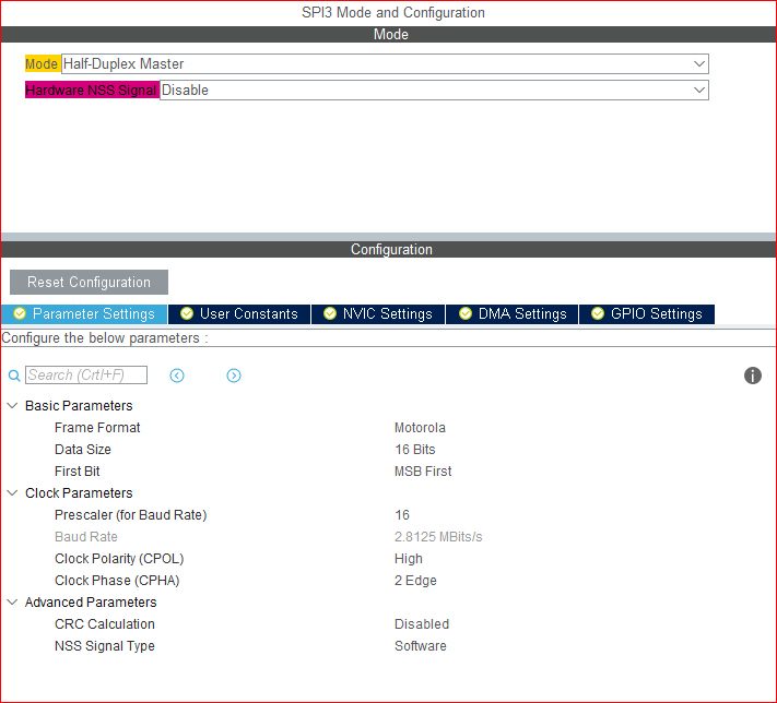

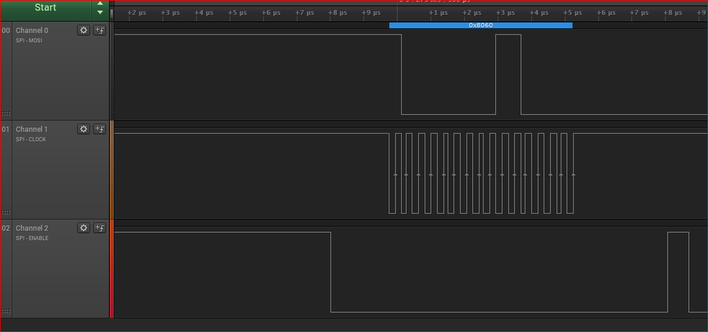

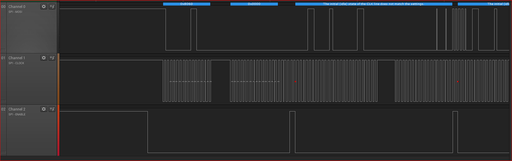

A Logic Analyser shows that there are same Errors on the SPI when i try to receive.

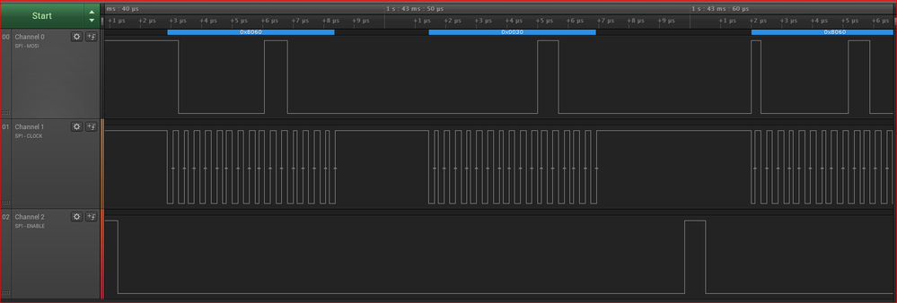

the SPI looks better:
