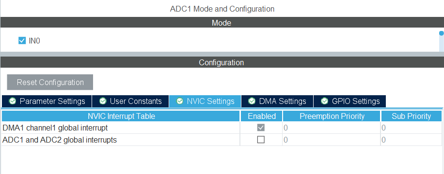

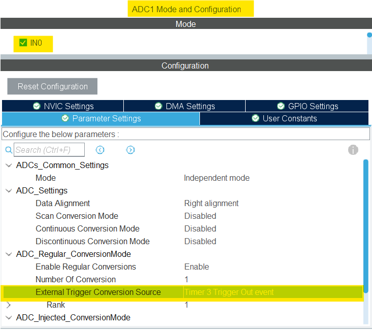

I have a STM32F103C8T6 bluepill board. I´m trying to use the Timer3 to TRIGGER the ADC1 conversion + DMA transfer.
The ideia is: when the timer 3 trigger the ADC1, a conversions starts and the dma transfer the result of conversion to a buffer, in circular mode.
I´m using the STMCubeIDE.
In the TIM3 Mode and Configurations, in the tab Parameters Setting, in the field Trigger Output (TRGO) Paramters, i´ve set Trigger Event Selection like Update Event. These settings are shown in the figure below.0693W00000Svu9oQAB.pngNo modo e configuração ADC1 fiz a seguinte configuração.

It's not working. I'm using an oscilloscope to analyse the GPIO PA6. Nothing happens there. The correct would i see a square wave at this port. i.e At each 10 conversions, the pin toggle the status.
What could be? Why it´s no working?

Thanks very much, but it wasn't necessary. I found the unblessed of the mistake.
The name of the function was written wrong. It was missing a letter.
The Correct: void HAL_ADC_ConvCpltCallback(ADC_HandleTypeDef* hadc1){
How i´ve written: void HAL_ADC_ConvCptCallback(ADC_HandleTypeDef* hadc1){
