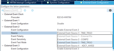

I did the exercise and I can see TIM2 TRGO is not grayed out for HRTIM external event 2 source:
and can be selectable:
What MCU part number you've set in CubeMx?
I've attached my ioc file.

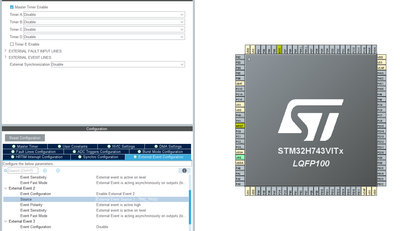

Thank you for  giving me hope but I am yet to repeat this in my configuration. My MCU package is STM32H743VITx (100 pins package) . TIM2 TRGO enabled and configured but still greyed out as a choice for HRTIM... I'll try to compare the .ioc files, will try to pinpoint the difference...

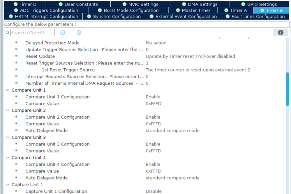

and setup as example Timer B : Enable all 4 Compare Units , disable the Capture units and set the 1st Reset Trigger Source to the "Timer counter is reset upon external event 2"
These are all relevant configurations for choosing/using the external events...

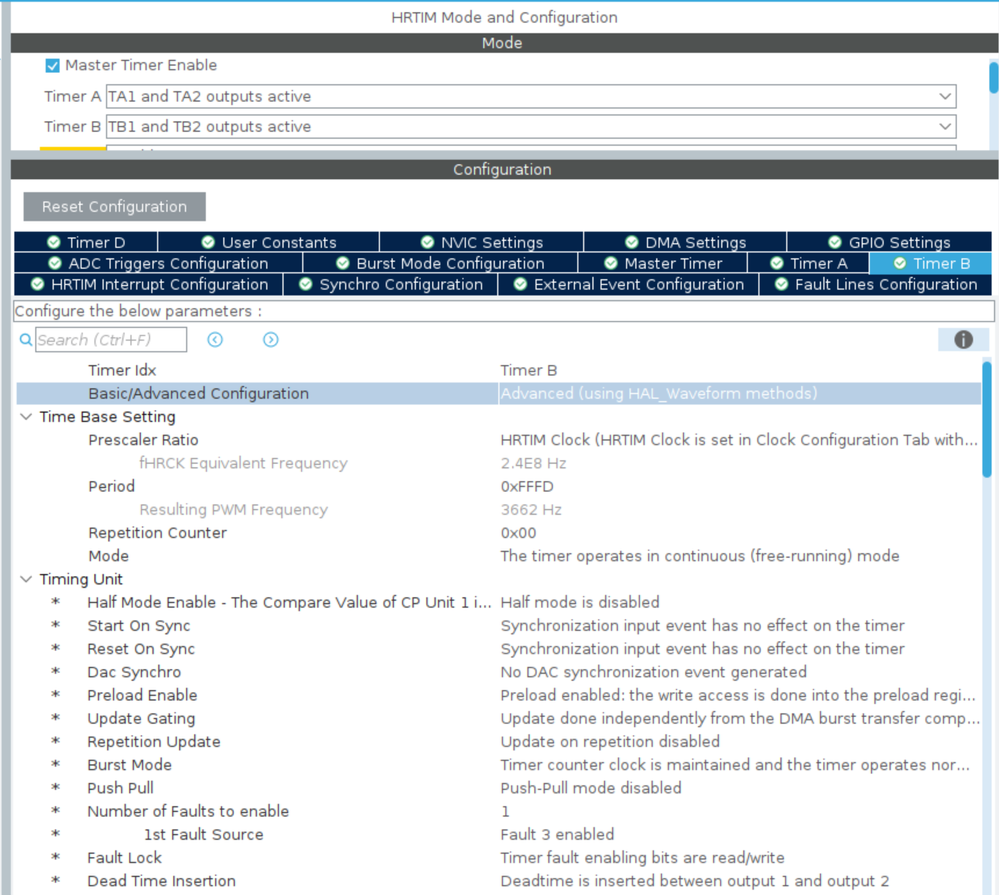

here are the main relevant parameters for this example Timer B setup . As per this configuration Timer B must be triggered By External Event 2 (which is TIM2 TRGO)   ....
Screenshot from 2026-04-28 15-50-09.pngScreenshot from 2026-04-28 15-51-05.png
Please let me know if you have the TIM2 TRGO enabled as External Event for triggering Timer B thus been setup.

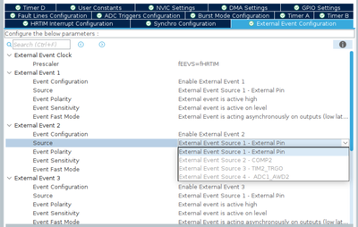

I only get  "External Event Source 1 - External Pin"  , Source 3 - TIM1 TRGO inactive. Again my MCU STM32H743VIT6 .
Please let me know, Thanks
TIM1 TRGO option is grayed out. Only External pin is available:
