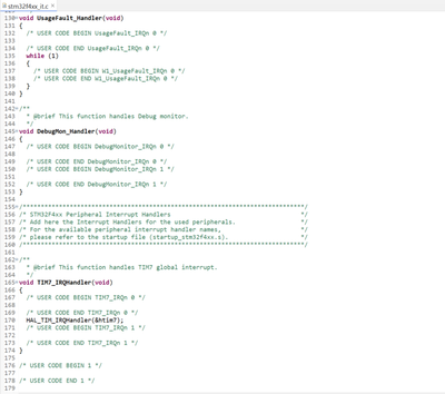

I attempted running a basic FreeRTOS example on a STM32F407VET6 board using CMSIS v2 following some tutorials, replacing systick for either TIM 6 or 7 as HAL Timebase as many tutorials suggest. The code only blinks and LED on the pre-generated task.
I could never get the program to work and by pausing execution I noticed it went straight to the default handler infinite loop. After reading a few posts it seems that the CubeIDE still does not generate the appropriate timer IRQ Handler within the stm32xxxx_it.c file and has to be added manually, as suggested by @Curtis B. on the posts attached bellow.
void TIM7_IRQHandler(void)
/* USER CODE BEGIN TIM7_IRQn 0 */
/* USER CODE END TIM7_IRQn 0 */
HAL_TIM_IRQHandler(&htim7);
/* USER CODE BEGIN TIM7_IRQn 1 */
/* USER CODE END TIM7_IRQn 1 */
Adding the IRQHandler fixes the issue but it is a bit frustrating that many tutorials follow the same steps and rarely mention this, since it usually works fine with other MCUs. I actually tested the same workflow for a STM32H773IIT6 board and for that MCU it worked perfectly, the IRQ handlers for the timer are generated and updated automatically by CubeIDE.

Hello @JulioCalandrin
I have performed a test with the latest version of STM32CubeMX 6.17.0, and it is working as expected.
I highly recommend updating to the latest versions: STM32CubeMX 6.17.0 and STM32CubeIDE 2.1.1.
PS : STM32CubeMX 6.17.0 is no longer integrated into STM32CubeIDE 2.1.1. Instead, the two tools are now interoperable.
