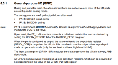

BOOT0 is shared with SWCLK, and as I'm debugging with a ST-LINK/V2, I didn't populate its associated components in my PCB, as shown:
Which component should I need to place? Maybe I'm thinking in that SWCLK pulls correctly BOOT0 (6.3.1 from the UM say so, but it's unclear), and such assumption might be incorrect.

Is it safe to place R100 and R101 from the SWCLK side?
A pull down is probably what you need.
If you place both pay attention to values chosen as now a potential divider.
If shorted to 3.3V resistors not going to make a lot of different.
If left to float BOOT0 will be in indeterminate state and why vector table mapping at zero is broken.

UM_6.3.1 says that SWCLK has a pull-down resistor:

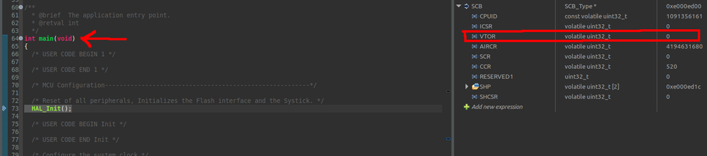

However, I've done a discovery: without the workaround the register SBC-VTOR is zero when reaching the main() function:
Captura de pantalla de 2024-11-19 14-42-35.pngWith the workaround such register takes the value 0x8000000:
