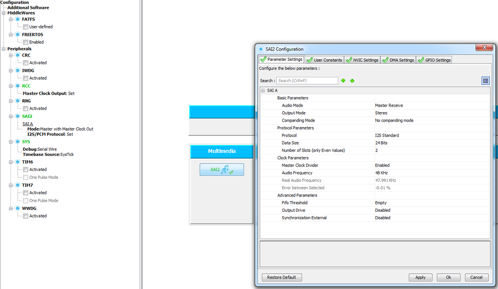

I'm having trouble setting up the SAI peripheral clock on an STM32L476RET6 using Stm32CubeMX (Version 4.25.0).
I want to use the SAI2A as Master Receive on a MEMS MIC ICS43434 with I2S with FS = 48KHz. and SCK = 3.072MHz.
FS = MCLK / 256
So I put 12.288 in the field ''To SAI2 MHz'' and press enter but CubeMX suggests 12.235...
12.235 / 256 = 47.79KHz would be a bit out of the way I want. So I put 12.288 * 2 = 24.576 and CubeMX suggests 24,571 which would theoretically give me a FS of 47.99 ... KHz which I think is good but when compiling on Keil (V5.24.2.0) and measure with my oscilloscope:
FS = 58.7KHz insted 47.99 KHz
SCK = 3.74MHz insted 3.07MHzMCLK = 15Mhz insted 12.285MHzthe microphone responds okay but obviously with an incorrect sampling rate for my application.
I also configured another pin so that I could measure the clock generated by the HSI and measure 16Mhz as well as expected.on my board I have a crystal of 16MHz but when using it I have the same results as when I use HSI.I tried varying ''RCC_OscInitStruct.HSICalibrationValue'' but only got +-3KHz approximately.Anyone have any idea what I might be doing wrong?

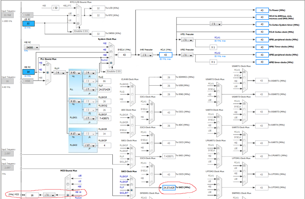

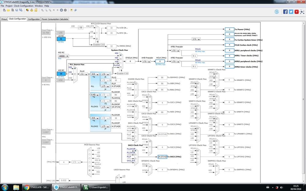

‎2018-04-07 11:39 PM
Hello!
today I successfully achieved Fs = 48KHz through the following clock setting ...
I tested the STM32L476, STM32L433 and STM32L432 microcontrollers with the same configuration and they all worked.
Strange, I'm using the same value (24.571429 MHz), but it comes from MSI instead of HSI. Should not it work well with HSI? I do not know but I feel better already :))
