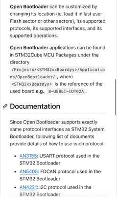

My recommendation to explore our Open bootloader example that should be supported by the STM32CubeProgrammer here :
https://github.com/STMicroelectronics/stm32-mw-openbl?tab=readme-ov-file

I imported the OpenBootloader softwarein my custom bootloader project, and everything works fine.
I can download a Application Program larger than 1 MByte using both the DfuSe Demo program and the STM32CubeProgrammer.
