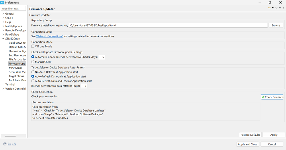

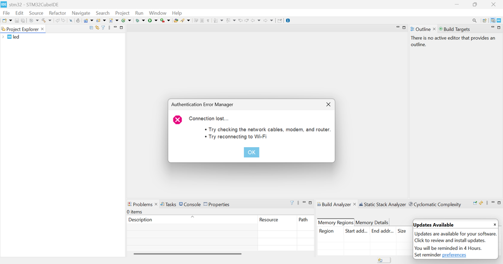

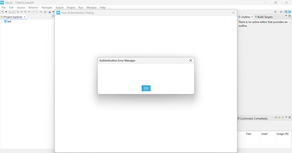

I am using STM32CubeIDE version 1.19.0, and I am encountering a network-related issue.
Problem
I receive the error:
“Authentication Error Manager – Connection lost”
Troubleshooting done
  • Verified that my internet connection is working properly
  • Tried using a mobile hotspot instead of Wi-Fi
  • Checked connectivity in the Firmware Updater (status shows OK)
System details
  • OS: Windows 11 Pro
  • Laptop: Lenovo ThinkPad T14
  • Board: STM32F407VGT6 / STM32F407 Discovery
Additional context
Even though the Firmware Updater indicates a valid connection, the authentication error still occurs across different network setups.
What could be the cause of this authentication/connection issue in STM32CubeIDE, and what steps can be taken to resolve it?

Please check the following LINK :How to set the network connection parameters for S... - STMicroelectronics Community where you can find a step-by-step guide to help you resolve the issue.
Another suggestion is to use the latest versions of STM32CubeMX 6.17.0 and STM32CubeIDE 2.1.1, in which the ST login feature has been removed from the user interface.

Let's try to  refresh, close, and reopen the project, restart CubeIDE, and reopen the .ioc. If that does not help, create a new STM32 project for STM32F407VGTx in the same IDE, configure a simple pin like PD12, and test generation; if it works in the new project, your original project is likely corrupted. If it fails there too, try a new workspace; if it works in the new workspace, the old workspace is corrupted. If the issue still persists, verify that the STM32CubeF4 firmware package is properly installed and recognized by CubeIDE, and as a last step, repair or reinstall STM32CubeIDE.
