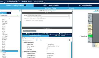

Use single-wire mode if you only want a single pin assigned. It'll use the TX pin even to receive.
Don't think Asynchronous mode has ever let you not use both pins, even if you select transmit-only or receive-only. Certainly not in the past few years. Please include an IOC file of that if you want me to check it out.
