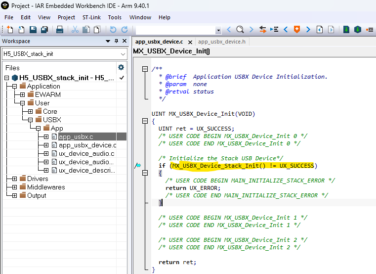

Ghofrane GSOURI
Hello @KaiY
After creating a from scratch IOC using the latest version of STM32CubeMX 6.17.0 and generating the code , the mentioned call above is generated successfully as shown below
THX
Ghofrane

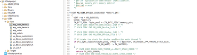

My test project does not have this code.
Perhaps it's with certain project settings?
Here is a screenshot and my .ioc file

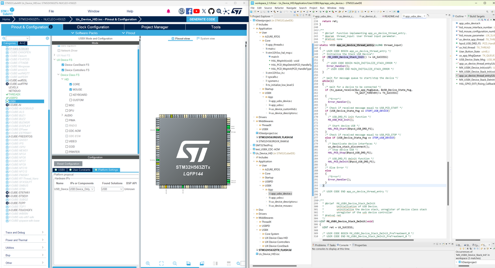

Hello @KaiY
After reviewing your IOC configuration, I compared it with the available examples and found that the Ux_Device_HID example is very similar to your setup.
In this example, the following code is present in the generated sources:
 if (MX_USBX_Device_Stack_Init() != UX_SUCCESS)
     /* USER CODE BEGIN MAIN_INITIALIZE_STACK_ERROR */
     Error_Handler();
     /* USER CODE END MAIN_INITIALIZE_STACK_ERROR */
This check is not inserted automatically by the code generator and must be added manually in the user code section inside app_ux_device_thread_entry, as shown in the following screenshot.
THX
Ghofrane
