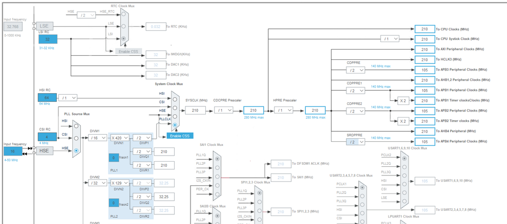

Hi, I'm trying to configure my stm32h7b0vb for max clock (280Mhz), but max freq on DIVN1 is 420Mhz, and DIVP1 is 2 (min val). Therefore I only reach 210Mhz
Solved! Go to Solution.

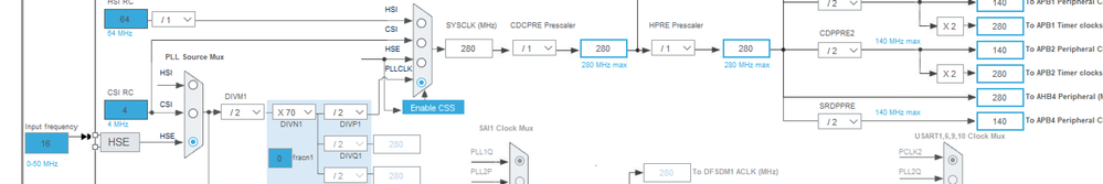

DIV1M can be less than /16. Here is one of several working scenarios:
Make sure you have VOS0 selected in RCC -> Power Parameters.

‎2022-03-08 3:52 AM
Thanks, I was trying to use DIV1M between 1-2Mhz!
‎2022-03-10 1:14 PM
Yeah, I think that was desirable for the PLL comparison frequency on the F2/F4 parts, but a lot of the H7 I typically see 5 MHz
I'd like to see ST provide characterization charts for the overall stability, but I've been disappointed for over a decade..
