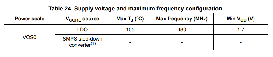

As mentioned in the Table 24. Supply voltage and maximum frequency configuration in the datasheet 12923
0693W00000aJZ6zQAG.pngVOS0 (power scale 0) is not available when the SMPS step-down converter directly supplies VCORE.

But I'm currently using this configuration (PWR_SMPS_1V8_SUPPLIES_LDO with PWR_REGULATOR_VOLTAGE_SCALE0) since older CubeMX version allowed it, and it works without any issues so far.
Why is that configuration not allowed, and what are the potential risks if I keep using it?

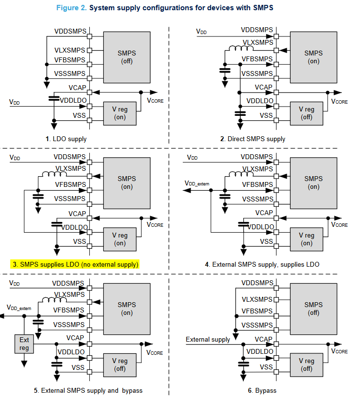

Are you talking about PWR_DIRECT_SMPS_SUPPLY option?
Does SMPS supply VCORE directly on PWR_SMPS_1V8_SUPPLIES_LDO option too?
"Are you talking about PWR_DIRECT_SMPS_SUPPLY option?"
I think he is, but I'm talking about PWR_SMPS_1V8_SUPPLIES_LDO option.
My understanding is that with the "PWR_SMPS_1V8_SUPPLIES_LDO" configuration, the VCORE is sourced from the LDO, that's why I'm confused why that option is now not available and it was in the older CubeMX.

I'm in the same situation, where both my hardware and my firmware are configured with PWR_SMPS_1V8_SUPPLIES_LDO and VOS0.
0693W00000bhUE7QAM.pngCould you please give us some insight regarding why SMPS_supplies_LDO and VOS0 shouldn't be used in conjunction, and what could be the consequences of such a configuration?
