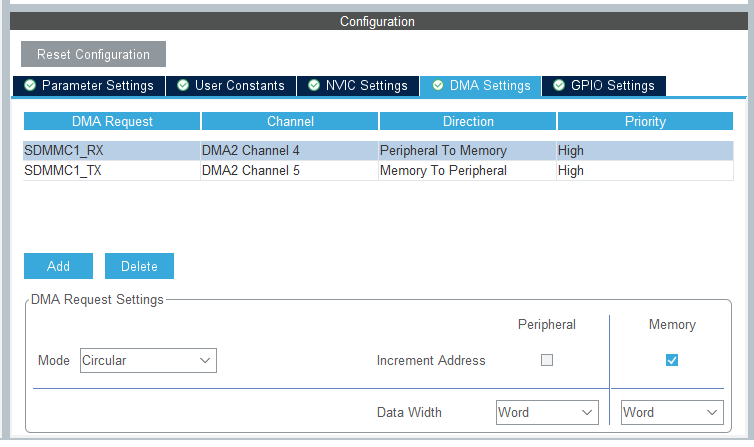

Without DMA (no DMA template in FATFS and no configured DMA channels) the SDcard works. When I use the DMA (see screenshot), the very first read operation stucks and after the 30s timeout I get an error.
I have investigated inside the code and I have the evidence that there is not any interrupt after the HAL_SD_ReadBlocks_DMA(). This is the cause of the timeout. The function itself returns no error, so it believes the data transfer is running, but it is not.

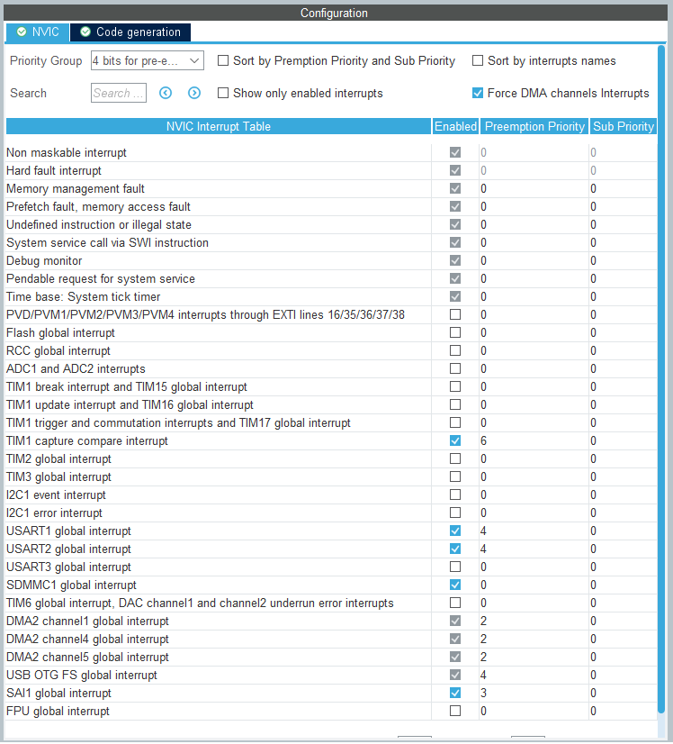

The interrupts are so configured:

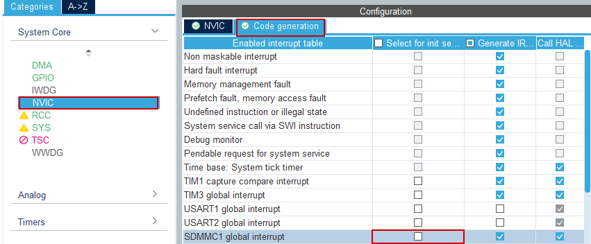

could you please enable the following option in the STM32CubeMX, regenerate your project and retest?
regards
Haithem.

Hi @Haithem Rahmani​,
I have enabled the option, regenerated and retested. The result is still the same: I get the 30s timeout after HAL_SD_ReadBlocks_DMA() and the SD_read() returns RES_ERROR.

Using DMA2 Channel 5 in TX and DMA2 Channel 4 in RX, as the configuration I have shown, the software doesn't read the SD and (as told) I get a timeout error when it tries to read the first SD sector. Whan this happens, the SDMMC controller have the RX OVERRUN flag set.
Swapping the two DMA channels (channel 4 in TX and channel 5 in RX) the read operations works without any problem at any SD clock speed, even at the maximum speed. But the write operations always fails, and this happens because the DMA2 Channel 4 interrupt is never called.
If I debug in single-step until SDMMC_CmdWriteSingleBlock(), and than I manually modify by the debugger the value of hdma_sdmmc1_tx->Instance, so it points to Channel 5 instead of Channel 4, the IRQ handler of the Channel 5 is called. Of course this handler is not the right one, because it is for read operations, anyway this prove that DMA2 Channel 5 makes its job and than it calls the IRQ.
All this seems to indicate that the DMA2 Channel 5 works correctly with SDMMC controller, while DMA2 Channel 4 never works.
CubeMX doesn't allow me to configure the software for using only the DMA Channel 5 (the only one that works) for both read and write operations.
What could be the cause of the failure of DMA2 Channel 4? This is the very important point because this failure makes impossible to uso the SD card with DMA data transfer.
