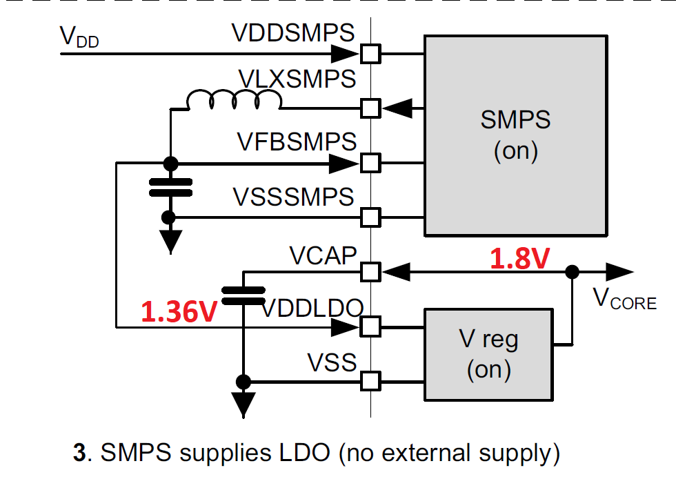

Greetings,
What is the reason for not being able to use the SMPS (or the SMPS supplying LDO) option for VOS0 on STM32H745II?
VOS0 means the highest voltage, so won't the dissipation on the LDO be the highest?
I have been using the PWR_SMPS_1V8_SUPPLIES_LDO option with VOS0 (core running at 480 MHz) and have seen no problem.
Can you please tell me what are the possible risks of using this configuration?
Best regards,
Domagoj

With the hardware layout n°3 ("SMPS supplies LDO" in the above picture), the SMPS seems to be active:
  • VDD = 3.3V
  • VDDLDO = 1.8V
  • VCAP = 1.36V
The internal sensor returns a temperature between 55°C and 60°C.
When disabling the SMPS (firmware configuration = LDO_SUPPLY), VDDLDO and VCORE are set to 0V and the MCU remains stuck (thus I can't get the measurement)
Edit: voltage measurements were swapped
So this is the situation you have:
0693W00000bhZElQAM.pngwhich is very curious.
How can the output of a linear regulator "V reg" be higher than the input?
EDIT: did you maybe reverse the order of the voltage nets?
I have now measured on my board, VDDLDO is 1.8V and VCAP is 1.36V.

@O'li​ With the above measurements, did you see the SMPS switching?
If it is really on, you can check with a scope at pin VLXSMPS or at the side of the inductor without the cap (so not the 1.36V side).

@Community member​ I think he has reversed the values of voltages.
I have now measured it on my board and VDDLDO is 1.8V and VCAP is 1.36V.
And also I have confirmed that the SMPS is working, the switching node before the inductor is outputing 2.3 MHz square wave and is regulating since the duty cycle is changing.
I have the same layout n°3 ("SMPS supplies LDO" in the above picture).
No, but with higher current: yes. ;)
The power the LDO has to dissipate depends on the in-out difference P = (Vin - Vout) * I
So with higher Vout the difference becomes less, so would the power dissipation, if the current stayed constant - which it probably isn't.
Yes you are correct that was a brainfart, I meant higher current.
Yes indeed, I'll edit my post to prevent further confusion
Same as @Domagoj Tomić​, I get a 2.3MHz square wave
