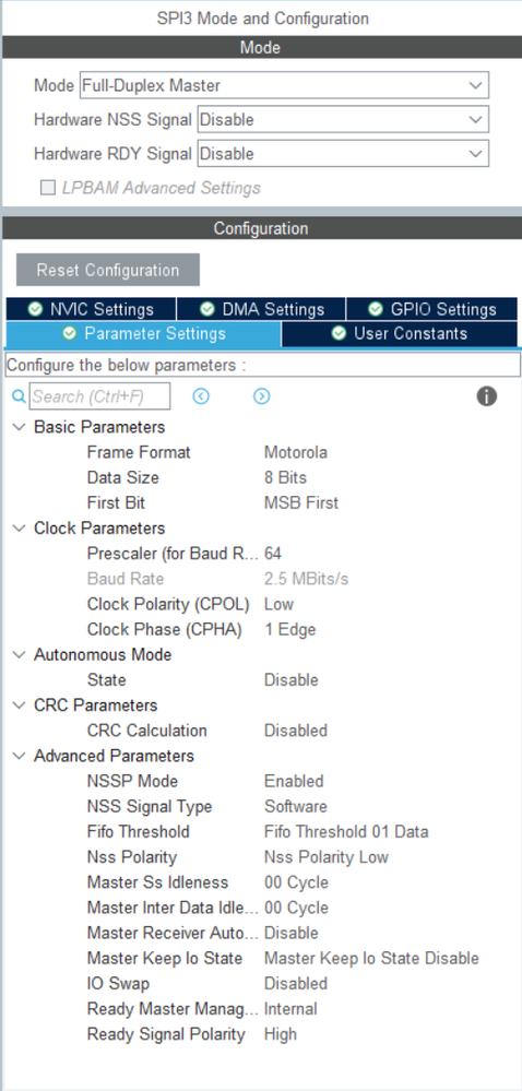

And here is my pin configuration:
I am trying to measure the clock signal with an oscilloscope that has a high enough BW to capture it, yet it seems that a clock signal is not generated.
I am not sure if there is something wrong with the way I initialize my device, or if there is another issue.

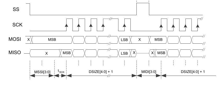

clk ? i see no sending of data - clk comes only with data bits to send 
see:
‎2023-06-08 6:59 AM
Hello @KKots.1​ ,
According to @AScha.3​ you should start the communication to have the CLK.
I recommend you to refer to the available examples in the STM32U5 CubeFW :
STM32Cube_FW_U5_V1.2.0\Projects\NUCLEO-U575ZI-Q\Examples\SPI
