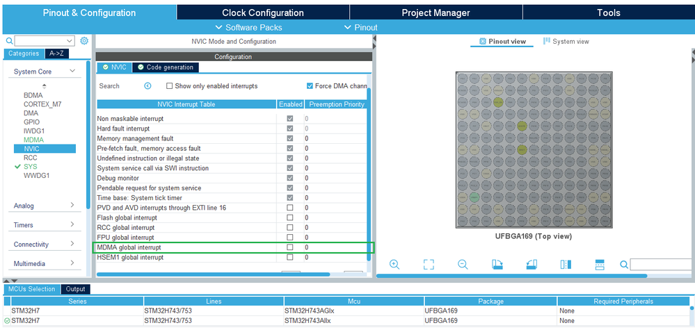

I register MDMA call backs, for example XferBufferCpltCallback, XferBlockCpltCallback, etc. using the HAL_MDMA_RegisterCallback() function. But the callbacks never got hit. These callbacks are called from stm32h7xx_hal_mdma.c/HAL_MDMA_IRQHandler(). HAL_MDMA_IRQHandler() in turn is called from stm32h7xx_it.c/MDMA_IRQHandler(). However, in my source tree , both CM4 and CM7, DMA_IRQHandler() is not in stm32h7xx_it.c as generated from CubeMX 6.1.1. And MDMA ISR is not in the vector table in startup_stm32h745bitx.s
I have looked at NVIC1, NVIC2, MDMA in CubeMX and can't find anything that would get MDMA_IRQHandler() to be generated. I would aprreciate it if someone let me know how to solve this problem.

Actually, this issue is reproduced only with H7 Dual Core, there is no problem with H7 Single Core devices.
Taking the example of STM32H743 MCU, MDMA global interrupt could be enabled through the NVIC Interrupt Table:
Thus, MDMA_IRQHandler () will be correctly generated in the stm32h7xx_it.c file.

Hi @BVu ,
Thanks for your feedback and for raising this issue, you're right there is not an option in CubeMX in order to add MDMA IRQ handler in the generated Code for H7 Dual Core devices.
This a known problem and it was already reported to our development team to be fixed as soon as possible. I'll surely keep you posted with updates.

Hi @Khouloud OTHMAN,
Thanks for confirming. Is the issue limited to the dual core H7? Or the singe core H7 is affected as well?
2021-04-21 01:00 AM
Hi @BVu ,
