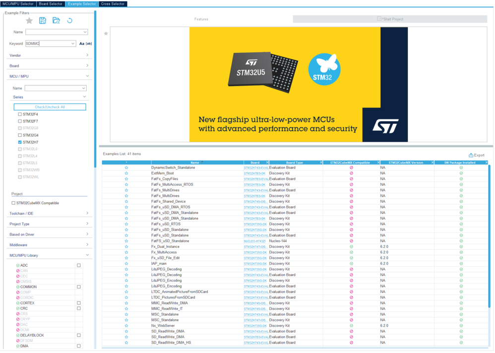

By my previous reply, I have tried to explain briefly the steps to configure SDMMC MDMA requests through STM32CubeMX GUI. Here is Application note to get started with STM32H7 Series SDMMC host controller with much more details and explanations.
You can also find multiple examples through Example Selector in STM32CubeMX developed to be a good start point for your project:
Hope this helps you.

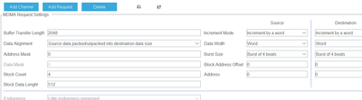

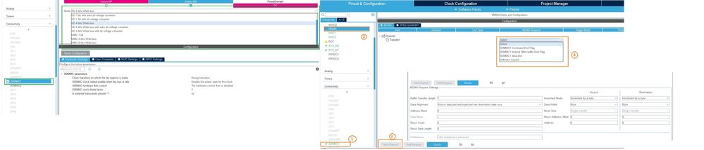

To Configure SDMMC1 MDMA requests through CubeMX, firstly enable the SDMMC1 by selecting one of the available modes. Then select MDMA and Add Channel, a transfer request will be created by default, you can select one of the available MDMA events from the drop down list. You can add later the requests you needs for your project and configure them according to your requirements.
Hereafter a screenshot to clarify more the process:
Hope this answers your question.
Khouloud.

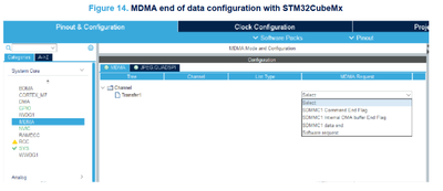

Below is page 16 from the referenced document. It leaves off explaining how to fill in the data farther down.
Page 16
Once the dialog box is open, the user clicks on the Add a channel button and selects SDMMC1 end of data. Now the user can configure the MDMA for the data transfer (buffer transfer length, data alignment, source and destination). See the figure below for an example of the dialog boxes that the user finds when doing this configuration. Figure 14. MDMA end of data configuration with STM32CubeMx
How are these items to be filled out??
