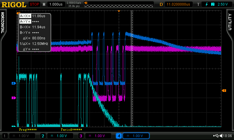

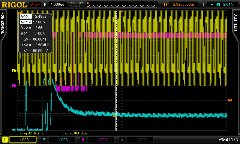

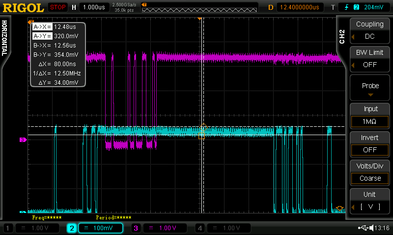

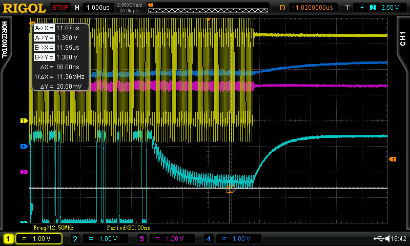

Hi TDK,
some (bad) news...
I moved back to PLL1and changed the RAM in Linkerscript (from DTCMRAM to RAM_D1)
(as suggested by T. Jaekel)
In my Opinion, the Result are more worst like before.
Let's start:
Here you can see, the Read-Data from Target will never send. (with 10k Pullup in CMD-Line)
This is when I used the Onboard-Pullup (82k) on the Target-Board in parallel with the STM32-Pull-ups. (approx. 40k)
The CMD-Line (light blue) breaks down immediately, the D0-Line (dark blue) and D1-Line (lilac) are not stable...
What's wrong here?
Again: Plug the Nucleo-F429 under the Target-HW -> perfect,
plug the Nucleo-H743 under the Target-HW -> chaotic signals.
The Setting for the GPIOS are GPIO_MODE_AF_PP / GPIO_PULLUP / GPIO_SPEED_FREQ_VERY_HIGH (same like F429)
To me, it looks like the Port-Supply (Port C/D) are not nailed to Vdd or something in the Supply is weak.
I don't have found in the RefMan from witch Domain the SDMMC-Unit is powerd (D1?).
in SystemClock_Config() the Supply is set to HAL_PWREx_ConfigSupply(PWR_LDO_SUPPLY);
Maybe, a Power-Safe-Function causes that issue?
Next I will half the SDIO-Clock.
But with the exactly same HW the App run with Nucleo-F429ZI.
