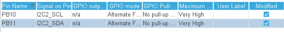

I've been working on a custom PCB with an STM32F427 and a TI audio amp (TAS5825M) that need to communicate using I2C. This is my first time using the STM32 line. I set up the project with STM32CubeMX with the appropriate settings for 100 kHz Master mode I2C on the I2C2 peripheral. Here's a picture of the pin configuration.

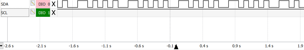

When I make the first call to the HAL_I2C_Master_Transmit, it runs until the address is sent and then fails. I believe that it fails because there is no clock signal and the receiving slave never acknowledges the presence of data, as shown in this capture of the scoped signals:
It just sends the address over and over as each message fails. In addition, notice how slow the data line is sending data! It takes about a second just to send an 8-bit address.
What am I doing wrong here, with respect to the clock and slow SDA speed?

Bad solder joint on the SCK pin?
In debugger, check the respective GPIO settings. Then change the respective GPIO_MODER setting from AF to Out, wiggle the pin in GPIO_ODR and observe.
‎2020-06-12 6:35 PM
Hello Jan,
Thank you for the reply. You are entirely correct. When I had initially probed for continuity I had only contacted the pad, not the MCU pin. I have since secured the SCK pin and it worked perfectly.
Thank you so much!!!
Best,
Andrew
‎2020-06-12 8:12 PM
And just for clarity - SDA was slow because of clock stretching feature. Turning it off would make it fast irrespective of actual clock signal.
