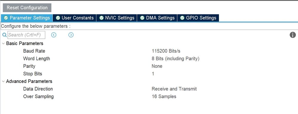

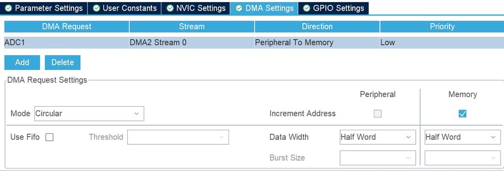

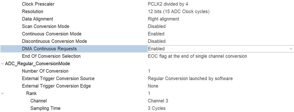

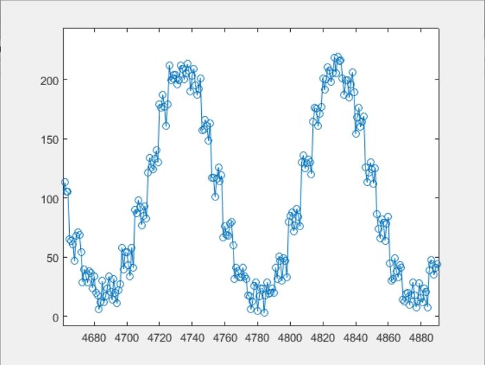

Stm32f407ve used ADC+DMA used 1KHz sin is not read evenly when reading the reason

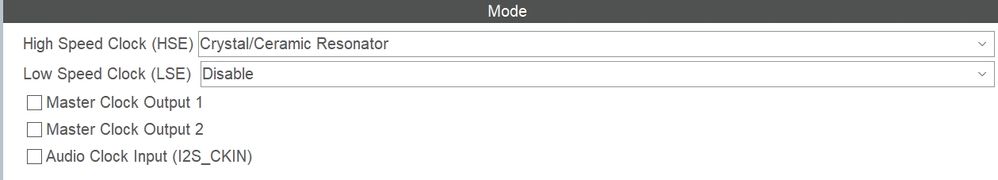

External 8MHz crystal and UART asynchronous use

You don't look to be pacing with a TIM, assume that you are saturating the USART.​
Options
‎2021-02-18 1:27 AM
I did not use the TIM. How to fix if USART is saturated? The code using USART was uploaded as a photo attachment.
