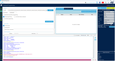

    August 30, 2024
    Here is the CubeMX Prog output when loading the test file from the STM QSPI repo ( a 1mb file)
    11:58:48 : Reset mode : Software reset
    11:58:48 : Device ID : 0x450
    11:58:48 : Revision ID : Rev V
    11:58:48 : Debug in Low Power mode is not supported for this device.
    11:58:48 : UPLOADING OPTION BYTES DATA ...
    11:58:48 : Bank : 0x00
    11:58:48 : Address : 0x5200201c
    11:58:48 : Size : 308 Bytes
    11:58:48 : UPLOADING ...
    11:58:48 : Size : 1024 Bytes
    11:58:48 : Address : 0x8000000
    11:58:48 : Read progress:
    11:58:48 : Data read successfully
    11:58:48 : Time elapsed during the read operation is: 00:00:00.008
    11:58:54 : Memory Programming ...
    11:58:54 : Opening and parsing file: testbinary1M.bin
    11:58:54 : File : testbinary1M.bin
    11:58:54 : Size : 1.13 MB
    11:58:54 : Address : 0x90000000
    11:58:54 : Erasing memory corresponding to segment 0:
    11:58:54 : Erasing external memory sectors [0 18]
    11:58:54 : Download in Progress:
    11:59:01 : File download complete
    11:59:01 : Time elapsed during download operation: 00:00:07.901
    11:59:01 : Verifying ...
    11:59:01 : Read progress:
    11:59:12 : Error: Data mismatch found at address 0x90000004 (byte = 0x00 instead of 0x11)
    11:59:12 : Error: Download verification failed
    11:59:18 : UPLOADING ...
    11:59:18 : Size : 1024 Bytes
    11:59:18 : Address : 0x90000000
    11:59:18 : Read progress:
    11:59:18 : Data read successfully
    11:59:18 : Time elapsed during the read operation is: 00:00:00.079

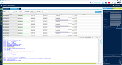

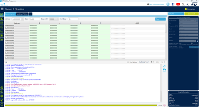

    mtechmattAuthor
    August 30, 2024
    Also, you can see the test binary contents:
    And the readback:
    So verification is rightly failing becuase the writing oft he data is not happening for some reason?
    I can load/debug and operate QSPI directly from sourcecode in the main IDE so we know HW is working properly.
