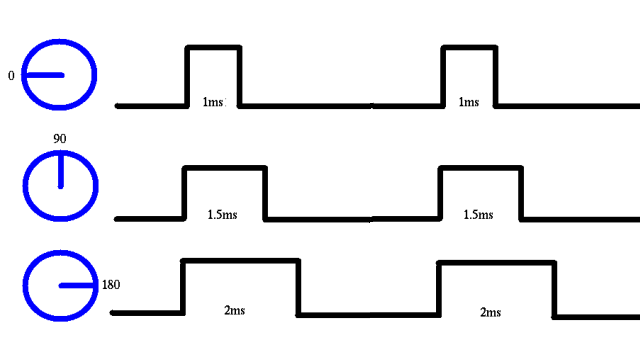

Hello, I am using an STM32F103C8T module (blue pill). I am using it to control a servo, which consists of a 20ms window, with a short pulse (1.0ms to 2.0ms). Like this:

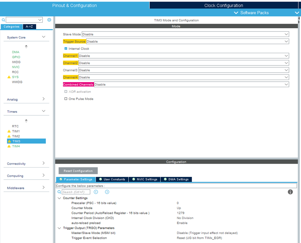

I configured timer 3 like this in CubeMX:

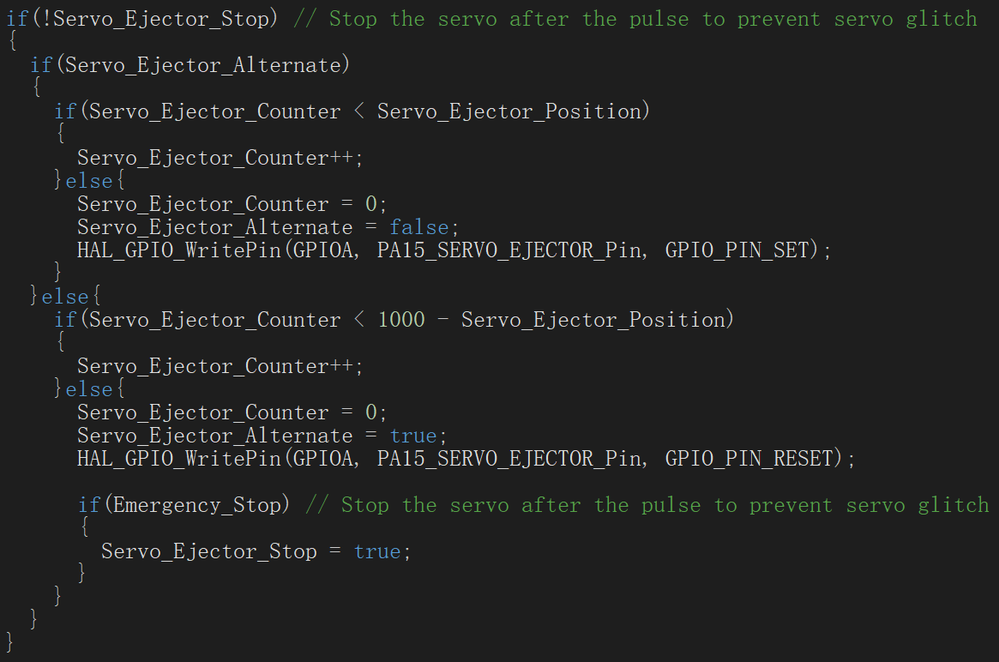

I am using "HAL_TIM_PeriodElapsedCallback", and here is the code that is driving the servo:

Does anyone know what the problem is? My servo driver code is extremely simple and I can't see anything wrong with it. Do I have the timer setup incorrectly, or is it something else? Any help or advice is greatly appreciated, thanks!

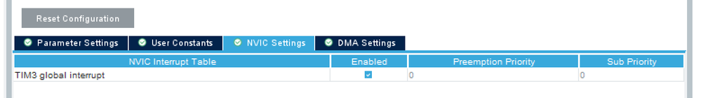

‎2022-06-27 1:42 PM
Thanks for the response! I checked the NVIC settings for this timer, and it shows both priorities to 0. Does this mean they are already top priority?
‎2022-06-27 2:05 PM
Maybe. This just means it's clicked so in CubeMX. But even if it's true, you still may have other interrupts of the same priority, resulting in interrupt latencies, so perhaps an easy way might be to decrease those (unless "priority grouping" setting prevents to do this effectively). There may be also other sources of latencies. And, at the end of the day, who knows what mcu exactly your bluepill contains and how does it exactly behave.

You're using interrupts.
Put the TIM in a 50 Hz 20 ms continuous operation.
A set the width of each of the channels to your 1-2 ms width.
Perhaps prescale the TIM so the thing clocks at 1 MHz (1us), then a CCR1 setting of 1500 will get you a 1.5 ms top-dead-center signal.
