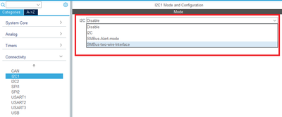

I am a new at SMBus communication. I design a board. Board have STM32F103 MCU and BQ40Z80. I need to make a communication between STM32 MCU and BQ IC but I couldn't find parameter settings in CubeMX.
Software is STM32CubeMX Version 6.11.1
I also attached a picture that shows there is no parameter settings for SMBus.

SMBus is configurable in that menu:

Umm well now I understood the request ..
Meanwhile, you can also refer to that package: X-CUBE-SMBUS and AN4502 "STM32 SMBus/PMBus™ expansion package for STM32Cube™"
Need toc check internally why there is only one setting in the parameters to set for SMBus!

Update: the fix is planned to be fixed in the next version CubeMx 6.12.0

Internal Ticket 181150 has been already created for follow-up.
