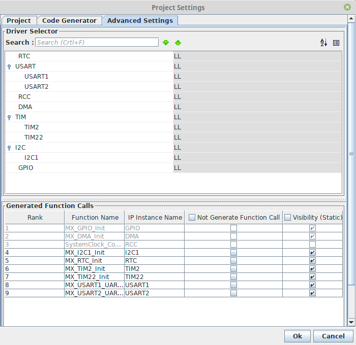

I use STM32L0 series microcontroller with LL and CMSIS libraries, no HAL is selected in the advanced settings tab, only LL.
And still, when I enable the "Flash and EEPROM global interrupt" in the Configuration -> NVIC, STM32CubeMX starts using the HAL library and generating code for it. As I understand, LL (at least for STM32L0) misses a module for working with Flash, but still, I think this is a bug.

More information: I have checked "Copy only the necessary library files" radio-button and "Generate peripheral initialization as a pair of '*c/*.h' files" checkbox.
After enabling the "Flash and EEPROM global interrupt" in the NVIC configuration window and re-generating the code I noticed that STM32CubeMX generated this function in stm32l0xx_it.c:
void FLASH_IRQHandler(void)
  /* USER CODE BEGIN FLASH_IRQn 0 */
  /* USER CODE END FLASH_IRQn 0 */
  HAL_FLASH_IRQHandler();
  /* USER CODE BEGIN FLASH_IRQn 1 */
  /* USER CODE END FLASH_IRQn 1 */
...and the stm32l0xx_hal_* files in the Drivers/STM32L0xx_HAL_Driver/Src directory. I don't have any HAL library selected, only LL. So this was an error, and I didin't even try to compile the code in this state (so can't look at the map file), because the existence of HAL makes my binary bigger than the Flash size of my microcontroller.
So I un-checked the "Flash and EEPROM global interrupt" in the NVIC configuration window, re-generating the code, this removed every mention of HAL from the code. Then I added a custom FLASH_IRQHandler function in one of the user code section in stm32l0xx_it.c, also another user function to enable the interrupt:

But my issue is that I don't want to use HAL, I selected only LL so I expect only LL and CMSIS functions in my linked binary. Don't you think this is a bug? Thank you!

 Your feedback is in line with the implementation of the CubeMX tool.
 Minimum code elementary initialization uses HAL implementation. This is not a problem and you can still use LL implementation for IPs, depending on your choice.

Thank you for your time. Please let me (as my last resort about this issue) express my opinion that in cases when HAL is not being used that "implementation" is not logical, and here is why:
  1. Although ST mentions the "Possible concurrent usage of HAL and LL" with some limitations, LL is marketed as a lightweight alternative to HAL, not a supplement. I didn't select the HAL library anywhere (as shown in the screenshot posted previously), and yet it's being used
  2. Confusion, as LL is lightweight and for example it doesn't come with its own systick handler implementing a global millisecond counter, so it was implemented in the user code. Now, after enabling the flash interrupt, CubeMX inserted HAL with its own systick handler which conflicts with mine.
  3. Unnecessary, why do we need HAL's FLASH_IRQHandler with its callbacks (that would be useful only when the firmware in fact uses the HAL functions) for a simple interrupt handler where HAL is not required anywhere else in the firmware? Just generate an empty FLASH_IRQHandler interrupt handler function with user code sections, and 2 lines of code somewhere to set the priority and enable the interrupt. And that's everything required.
