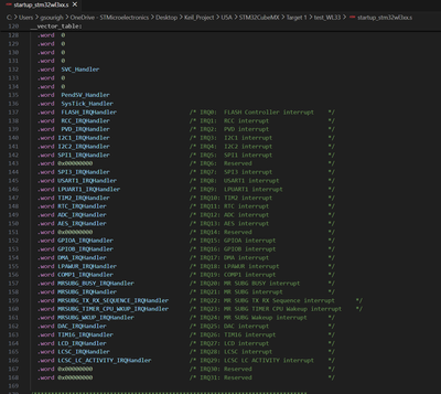

Ghofrane GSOURI
Hello @ncdanie
Using the latest version of STM32CubeMX6.17.0
  .word MRSUBG_BUSY_IRQHandler                /* IRQ20: MR SUBG BUSY interrupt        */
  .word MRSUBG_IRQHandler                     /* IRQ21: MR SUBG interrupt             */
  .word MRSUBG_TX_RX_SEQUENCE_IRQHandler      /* IRQ22: MR SUBG TX RX Sequence interrupt      */
  .word MRSUBG_TIMER_CPU_WKUP_IRQHandler      /* IRQ23: MR SUBG TIMER CPU Wakeup interrupt    */
  .word MRSUBG_WKUP_IRQHandler                /* IRQ24: MR SUBG Wakeup interrupt      */
THX
Ghofrane
