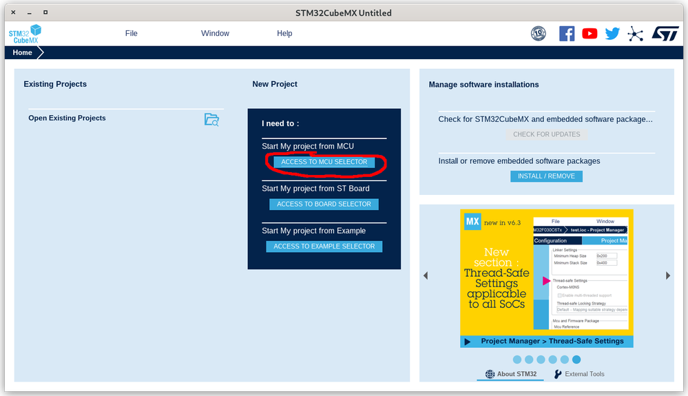

stm32cubemx failed to open ACCESS TO MCU SELECTOR
‎2023-01-17 10:51 PM
When I click ACCESS TO MCU SELECTOR, the console prints :
2023-01-18 14:35:27,011 [INFO] MultiScanPanel:196 - Auto-refresh data requested => check proxy status ongoing
2023-01-18 14:35:27,014 [INFO] FinderPluginLoader:92 - Searching for filters in installed packs
Failed to load native library:sqlite-3.34.0-2c9e6182-4a79-4303-b6d5-9dd5ff21406c-libsqlitejdbc.so. osinfo: Linux/x86_64
2023-01-18 14:35:27,102 [ERROR] MicroXplorer:720 - Failed to load native library:sqlite-3.34.0-2c9e6182-4a79-4303-b6d5-9dd5ff21406c-libsqlitejdbc.so. osinfo: Linux/x86_64
java.lang.UnsatisfiedLinkError: /tmp/sqlite-3.34.0-2c9e6182-4a79-4303-b6d5-9dd5ff21406c-libsqlitejdbc.so: /tmp/sqlite-3.34.0-2c9e6182-4a79-4303-b6d5-9dd5ff21406c-libsqlitejdbc.so: failed to map segment from shared object
com.st.microxplorer.db.DbException: Can't connect to CubeFinder SQLite database (/home/maegami/.stmcufinder/plugins/mcufinder/mcu/cube-finder-db.db): Error opening connection

‎2023-01-18 2:46 AM
Hello @yl.1​
Please check this LINK in order to download the latest version of CubeMX 6.7.0
Could you please re-test with it and check if the issue persists.
I will be waiting for your feedback.
Thx
Ghofrane
‎2023-10-13 8:36 PM - edited ‎2023-10-13 8:44 PM
It happens when two monitors are connected and a certain configuration.
I have 3000x2000 laptop monitor with 200% scale and a second 1920x1080 with 100% scale. The second monitor is set as main.
Setting laptop as main fixes the problem temporarily.
I am on Windows.
