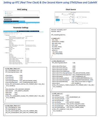

Setting up RTC (Real Time Clock) & One Second Alarm using STM32hxxx and CubeMX
aahsan
I am using above settings and functions for RTC and One Alarm, also attached with this post as RTC_and_One_Second_Alarm_Setup_using_STM32hxxx.pdf, please review and let me know if you see any issue. Thanks in Advance.

KDJEM.1
Hello @aahsan ,
I recommend you, when you configure the RTC Alarm with interrupt using STM32CubeMX, to follow the steps shared in Getting started with RTC - stm32mcu Wiki. The aim of this wiki is to explain  how to setup RTC with interrupt in STM32CubeIDE and how to create a simple RTC project with periodic alarm interrupt.
Also, I think that this example  STM32CubeH7/Projects/NUCLEO-H723ZG/Examples/RTC/RTC_Alarm at master · STMicroelectronics/STM32CubeH7 · GitHub can help you.
I hope this answer your request.
Thank you for your contribution in STCommunity :).
