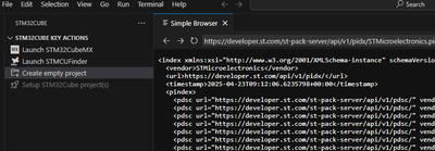

I can open the https://developer.st.com/st-pack-server/api/v1/pidx/STMicroelectronics.pidx in the Simple Browser of VScode:
So now I'm not sure anymore if that is a proxy issue.

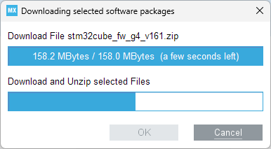

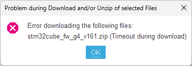

When I try to download a new MCU package in STM32CubeMx (in this case STM32G4, as the H7 is still installed), I get the following error:
But when I try a second time, the download goes one step further, but gets stuck here:
and after a few seconds it fails again:
It seems that the download is finished, but then something goes wrong. Maybe the unpacking process?
This way it is not possible to install the latest G4 1.6.1 MCU package even if I try several times.

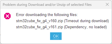

But the G4 1.6.0 package can be installed.
For STM32F4 MCU packages, it is possible to install 1.28.0 on the first attempt, 1.28.1 after the second attempt and v1.28.2 after several attempts.
Ist there maybe a timeout value to short?
