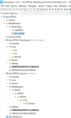

2- Specifying the steps you took to reproduce the issue would be helpful.
Those are the steps that I took using CubeMX 6.12.1 and STM32CubeIDE 1.16.1
through the IDE, right-click on the Third_Party folder in the Project Explorer, select New > Folder, and name it accordingly.
By using CubeMX, I generated the code and the added folder was present.
THX

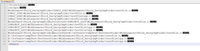

To prevent random file delete, I suggest to use .extSettings file where you can declare your own files:
Example:
[ProjectFiles]
[Groups]
Middleware\Third_Party\myFolder= <path to c file 1>;<path to c file 2>;<path to c file 3>
[Others]

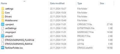

.extSettings file will be located at the same level as the ioc file.

In the meantime I tried to use the .extSettings File. Where I was not successful. Then I tried also different path types in the .extSettings file. I thought maybe there could be the problem, but the different path types are also not solving my problem.

Here is my list what I did:
1. Generate new File Project with CubeMX
2. After Generation imported project into STMide
3. Add Over CubeMX X-CUBE-FREERTOS (adds MiddleWareFolder)
4. Add "myFolder" over Windows Explorer
5. Refresh on IDE
6. Generate new file over IDE (testFile.c and testFile.h)
7. Copy other files over Windows explorer into myFolder
8. Copy folder to test different settings in .extSettings
9. Add files to .extSettings
10. Change something on a middleware library (changed something in freeRTOS)
11. Generate
12. Folders are gone
I think every time when CubeMX has to modify something inside the Middlewares/Third_Party/ it deletes my folders.
Maybe with the additional information you have another idea, where my problem is. (I added my whole test project)
